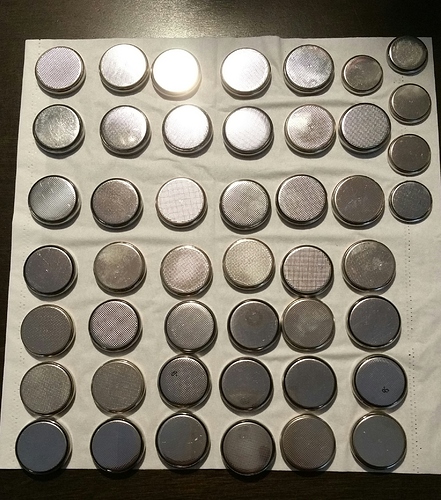

Just before I go to recycle the cell coins batteries I used since I started with SmartThings, I took a picture.
Strangely, I don’t think this is following the intent of 1 year on battery requirement I read once.
This is the consumption I had over 18 months with 15 multipurpose sensors, 4 Motion sensors (I stopped using 2 of them since 6 months now) and 3 arrival sensors (I stopped using them 6 months ago too). There are of course 17 more currently installed in the sensors.
Not sure home automation is that green…
So 46 batteries and 22 devices? All from smartthings-branded devices, so all zigbee?
That’s not good. It’s not horrible, but it’s not good. It’s about five months average life.
