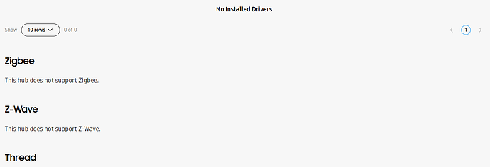

ST hub died so I purchased sth-eth-1 on ebay, actually new in the box. Registration ok. Won’t connect to anything. Using my.smarthings.com advanced it shows hub doesn’t support zigbee and hub doesn’t support zwave. Could that be accurate?

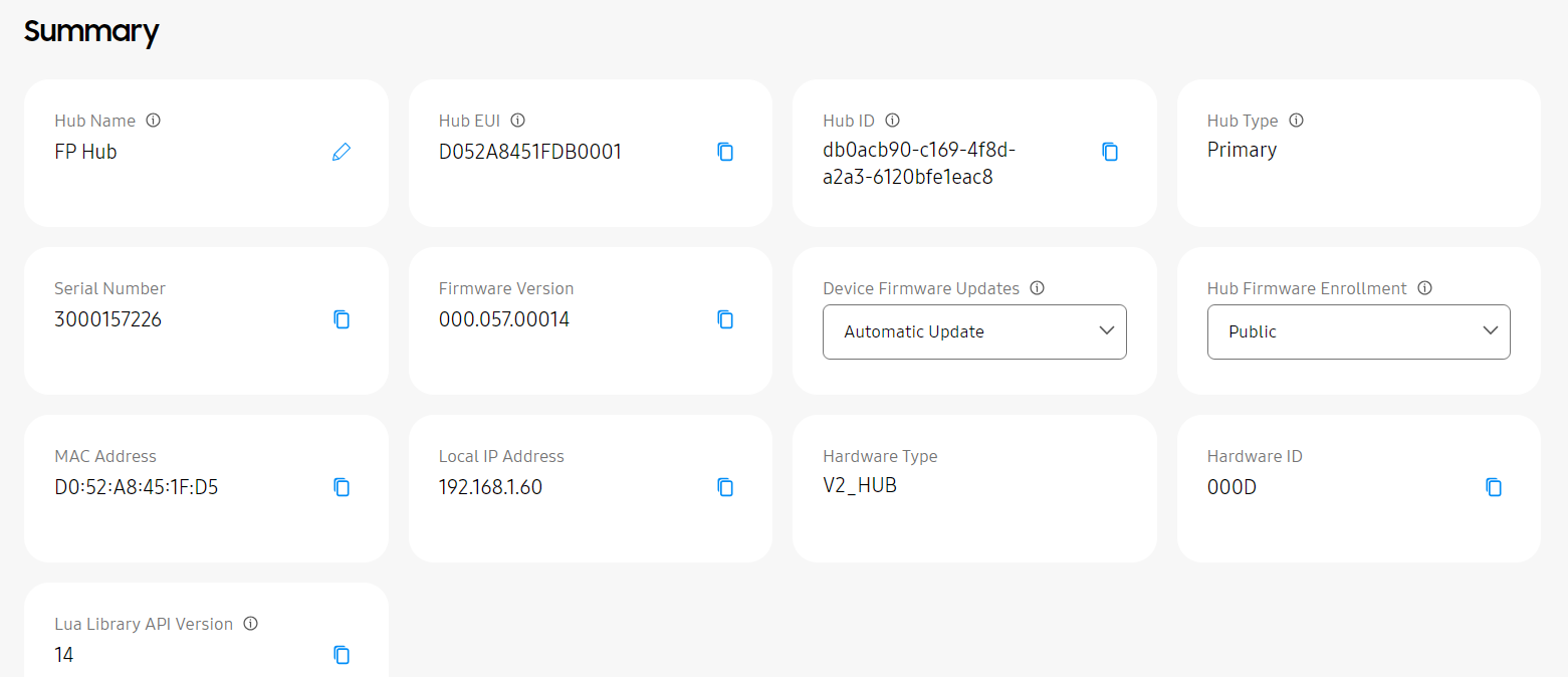

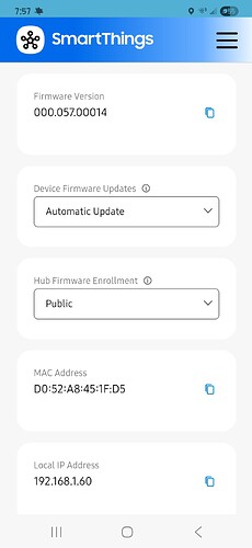

Sorry, I am a bit confused. On a laptop I get much more expansive hub details.
Also one of your pictures has a Firmware Version: 000.057.00014 (the latest version that I have) while the other has ‘blank’.

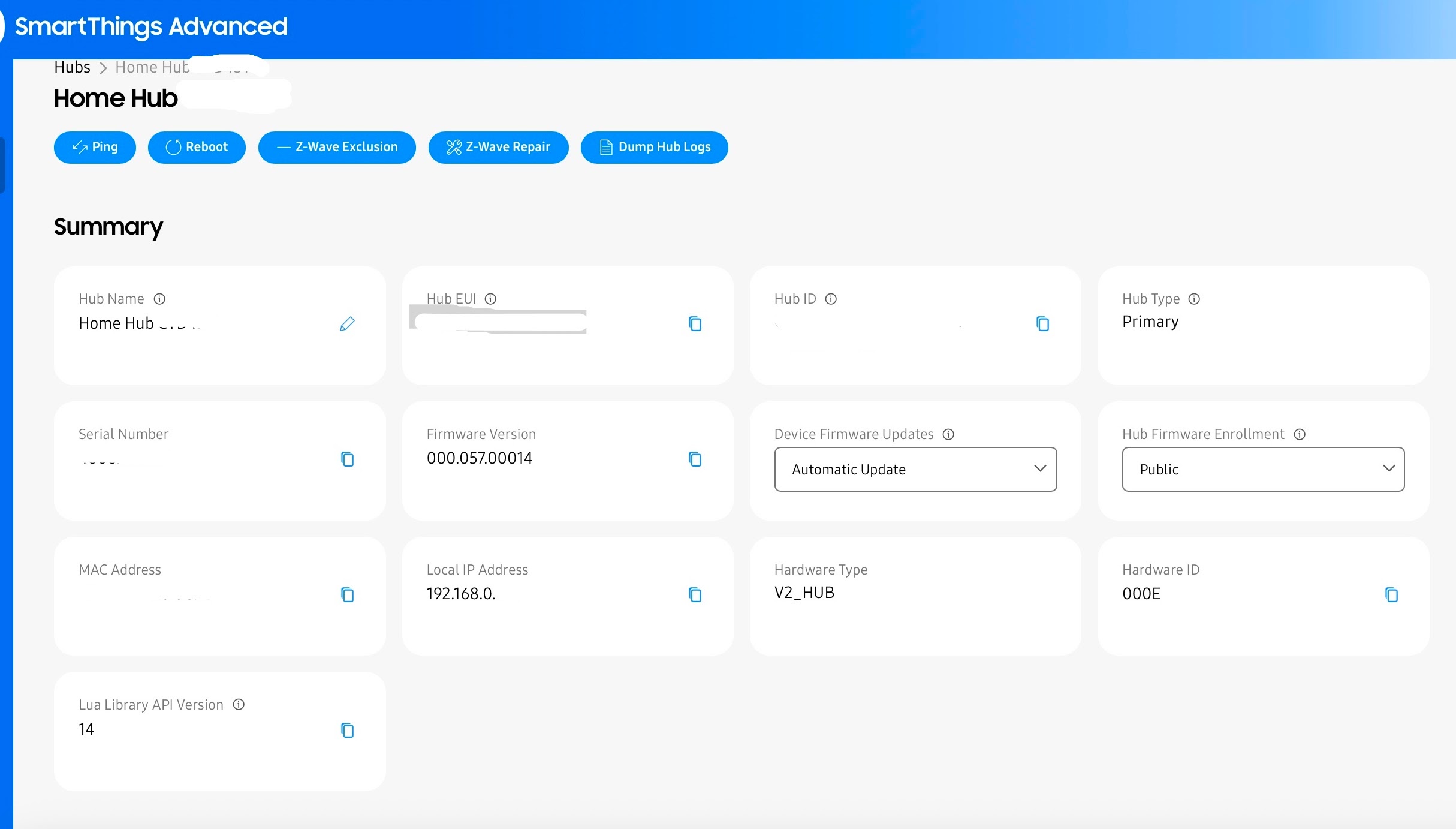

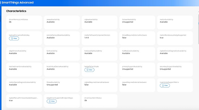

The following are the (obfuscated) Summary and Characteristics for my spare V2 hub:

Yes, so the one with firmware 57.0014 is from my running device (since 2018) and the other is from one I purchased from eBay to configure for a friend whose hub just died. I have been able to use the code and add the hub and can see it in ST. However, in the advanced it shows no firmware and zigbee and zwave unavailable. ST support states that this is because it is an older device. I have two devices that do exactly the same thing. Someone suggested an expired certificate and I tried the reset procedure followed by blocking NTP but that did not help. It would really be nice to have a conversation with the next level of engineering and I am in the process of writing to Samsung North America to ask for assistance. It is truly frustrating.

Using a laptop, or other larger screen computer, can you produce the equivalent of the two screenshots I gave as an example. Do this only for the problem hub. I was hoping to see the complete Summary and Characteristics to understand as much as possible about the problem hub.
