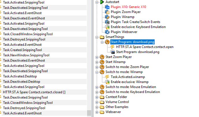

Installed the Web Server, my test was successful. Created a folder called SmartThings, added an action to open an image when Contact is open. Setup the SmartApp, EventGhost is receiving the activity now and executed the command.
The only problem I see so far is the reliability of the response from SmartThings. It could take a few minutes to respond to an open sensor or not read the open/close at all sometimes.
Or when it is OPEN, it will read CLOSED. Weird.

I just tested it with a ST switch now, sometimes it is instantaneous, other times it does not register or it will be the incorrect value (ON/OFF) - same as the contact sensor.
Most of the time, if turn my lights ON, wait 10 seconds, turn them OFF, EG won’t register it.
Wait 30 seconds, turn them back ON, EG registers the lights as turning OFF. It gets out of sync while also missing events.

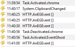

I also did your test again and only did it once. But it registers 4 times and once randonly 35s later? Is that normal?
Not normal. Weird indeed.
