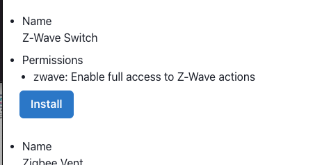

I have installed Z-wave lock driver and never installed z-wave switch. However, the lock driver shows z-wave switch and no option to change driver type to z-wave lock.
Assuming you clicked on the Driver menu option for a device, what you are seeing is that the device is use the Z-Wave Lock driver and when you click on “Select different driver”, it’s presenting you with other compatible drivers from which to choose.
What are you trying to do/see?
Oh that makes sense now. However, I’ve never installed Z-wave switch. It’s weird that there is an option for that.
I was trying @DigitalDan 's suggestion to change the driver type.
In that case, I’d suggest changing the driver type from within the SmartThings app.
I thought I should change to Z-wave lock but did not see the option and saw the Z-wave switch I didn’t install so I was confused.
