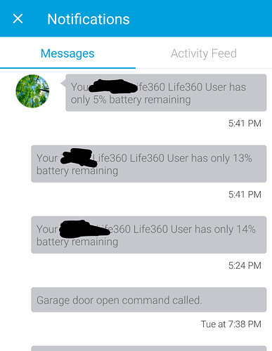

Started getting SmartThings popup notifications for users having low battery level. So actually getting a notification on my Android phone. I do not see an option controlling this. Any idea where these are coming from and how to disable them?
Sorry I do not know but its not this app doing it
You need to remove any device from webcore and readd it will then list all the new attributes in webcore
