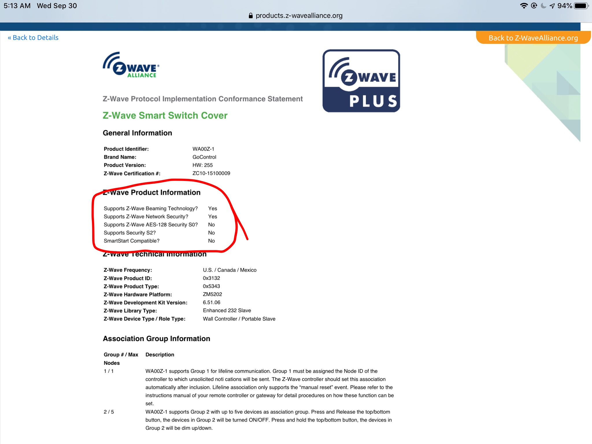

This is GoGO control button is an older device that doesn’t support zwave security.
It doesn’t support the newest “S2” zwave security framework, but it does support the base level.
https://products.z-wavealliance.org/products/1529/embedpics
In practice for a light switch that doesn’t make much difference. :sunglasses:
The important thing, as you mentioned, is that zwave direct association between this device and one with the newest security level, S2, probably won’t work.
