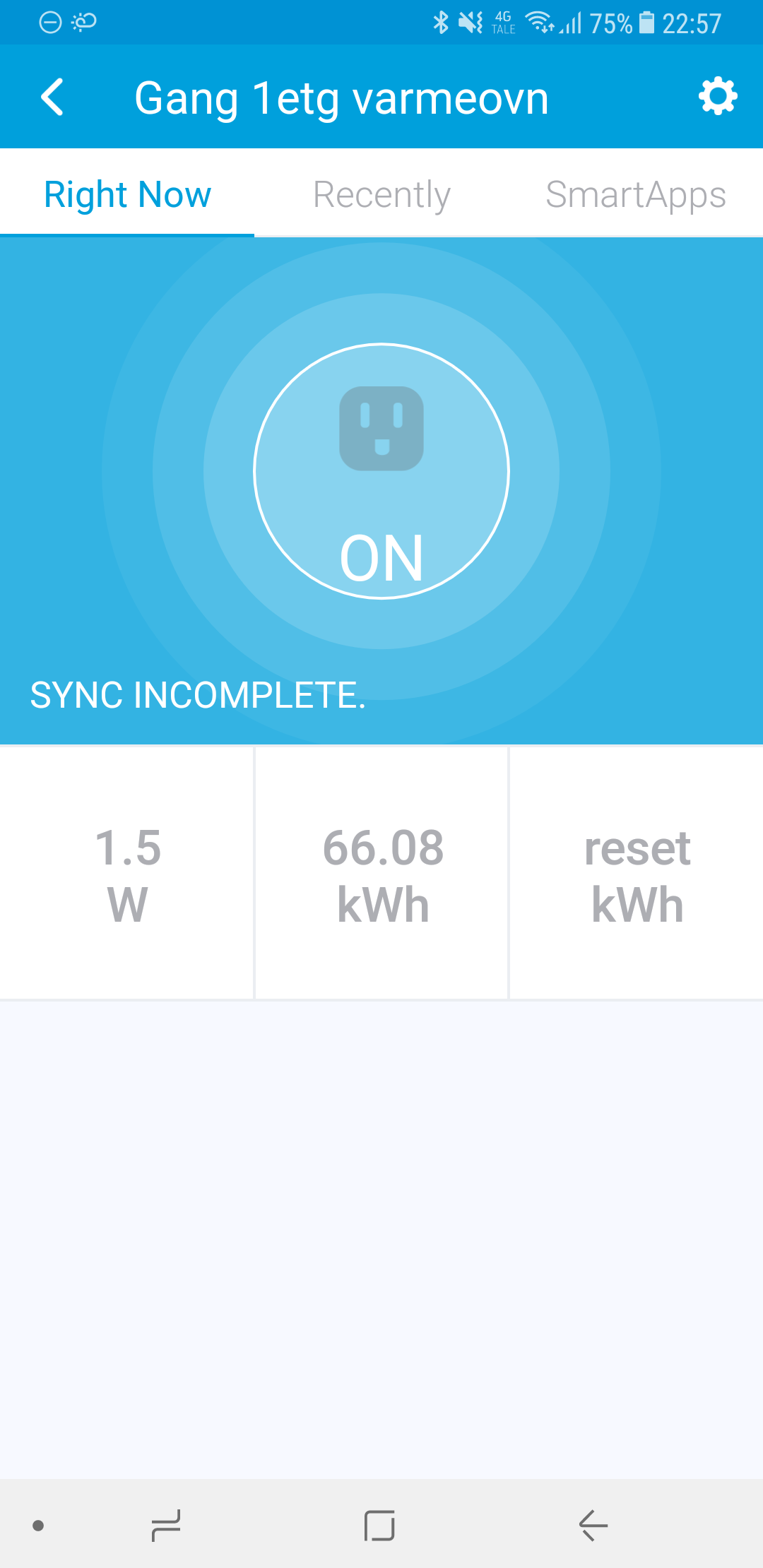

Hi, I can’t get my two fibaro wall plug zw5 (102) to work. They communicate with the hub and are reporting consumption and state, but I can’t turn them on or if from the app or from webcore.
Updated to the latest version of the device handler, but didn’t help. They where both working earlier.
Have tried to delete one of them and added it back. Didn’t help either. Tried another device handler that didn’t work. I have deleted the device handler from the ide afterwards, and I have checked that the devices uses your handler.

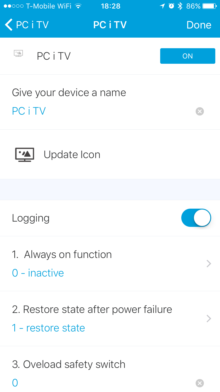

If I change a value in the settings for the device in the app, it reads “sync in progress” and soon after it says “sync incomplete”. Here are two screen shots from the app and preferences on the device in ide.
Enable logging and post the logs for sync here. Also try enabling and then disabling param 1 “Always on function” - I can see you used different DTH previously and maybe you enabled this setting (Wallplug in this mode will ignore off commands and be always on).
Noticed the hub stopped responding yesterday evening when night mode didn’t turn off the lights. And this morning, the morning routine didn’t run either. So I pulled the power plug and batteries from the smartthings hub. When I left home, the routines were running as normal again.
Did as you suggested and set “always on function” on and off on both mye wall plugs, and everything sync as it should.
So now I can turn the power plugs on and off from the app. Haven’t been home yet to verify it, but it looks promising.
Guess the clean up and removing device handlers not in use, and the restart of the hub did the trick. Maybe some of the parameters in device handler wasn’t set either.
