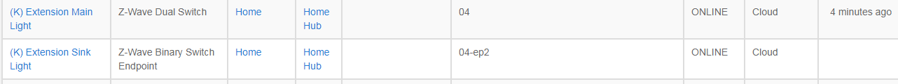

Having spoken with STT support I have changed the drivers on the Fibaro Single Switches I have back to the stock Z-Wave Switch Generic so that these devices are now seen and treated as local. Using Smart Lighting Apps now means I have some very useful local processing now.
However I have 12 Fibaro Double Switch 2 FGS-223 all using Eric’s excellent DTH. This means STT sees them as cloud devices as it is a custom handler.
Does anyone know of a way to get these devices Local? A stock handler? Or is it that there are 2 endpoints on the single switch that is the issue here.
I would really appreciate some advice & help with this challenge

i tryed these stock ones for a double swithc, but they dont local process anyway
Thanks Mark
Does anyone know why even the stock dual switch device handlers run in the cloud and not Local?
ST havent got a stable one they wish to deploy onto your box? i dont know, they dont seam to bothered about developing/expanding the system. i havent seen a new local device added sice ive been using it, i check this often
https://graph.api.smartthings.com/localDevice/list?sort=minHubCoreVersion&order=desc
