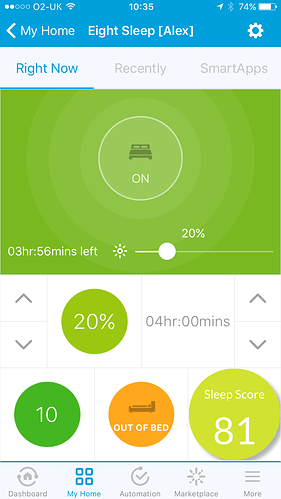

#Screenshots

Using the King size Eight Sleep Cover
Installation went smoothly. Can see the bed warmer is active and counting down. Looking forward to the morning and seeing the stats showing up. Great start!
