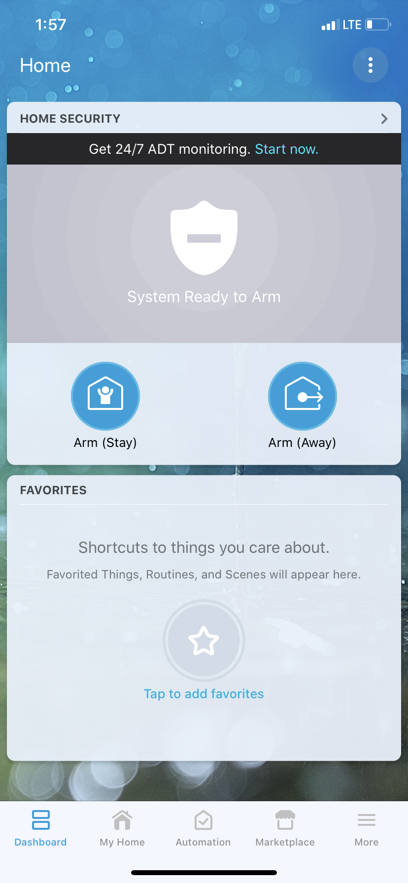

Hey guys, I know this might not be the right place to post but in the app both classic and new, have y’all noticed the disarm button disappeared? I only have two options now Arm(stay) and Arm(Away). How do I get the Dísarm button back?
I believe the disarm button will appear once you put the alarm panel in one of the Armed modes. That is the ADT Dashboard which is not part of the ADT Tools smartapp.

That display indicates that alarm is “DISARMED” already and “Ready to Arm”, when you arm it (Stay or Away mode), then the “DISARM” button will appear …
