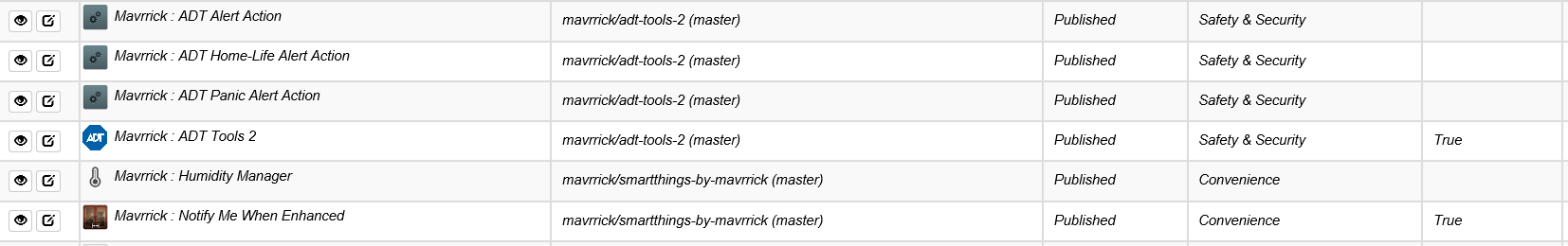

I see the following:
Phone
ADT Tools 2
IDE
[Mavrrick : ADT Alert Action ]
[Mavrrick : ADT Home-Life Alert Action ]
[Mavrrick : ADT Panic Alert Action ]
[Mavrrick : ADT Tools 2 ]
[Mavrrick : Humidity Manager ]
[Mavrrick : Notify Me When Enhanced ]
Is the humidity manager and the notify me app connected to ADTTOOL2?
In the IDE click on Location.
Next to your location click on “Smartapps”
Scroll down until you see ADT Tools 2 listed
If you see any child apps under ADT Tools 2 you can scroll back to the top and click on edit.
Scroll back down and select delete next to the child apps. Then you should be able to delete the parent app.
That did the trick for uninstalling the child apps but when I try to uninstall the adttools2 from my phone I still get the http 409 conflict error
You should be able to do the parent app the same way.
I had to first delete the Armed/Disarmed buttons that were linked to ADTtools2.
I was now able to delete adttools2 and will reinstall from your repo.
