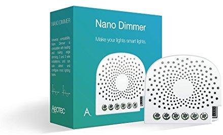

Recently I picked up this as a dimmer that I am going to put on the light. It says in the product description that it can do some fans but does not specify which. Most posts I have read say that you can not control fan speed with a dimmer as it is bad for the motor. I was thinking of giving it a shot and see what happens.
Would love to have a small device like either of these that can do fan speed control. As far as I know there are still no options available other than 1 gang fan speed controller. Is there? Also, why not? Seems like there is a huge hole in the market right here and there has to be a reason why. Patents? Technical constraints?
For a variable speed fan control, you need three separate windings. I just don’t think there’s room in a micro, smart or not.
