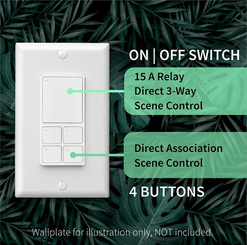

  3. In the under $30 category, Zooz has great Z wave engineering, all the latest and greatest, and very helpful technical support. Several different models with different features. Very popular in the forum.
Zooz is the house brand for the retailer the smartest house. You can buy from them or on Amazon.
Zooz also has a really cool scene controller with four small buttons you can use for changing location mode, changing smartthings home monitor mode, scenes, etc. The company provides the custom edge driver you will need.

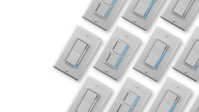

  1. Inovelli is another popular Z wave brand in the community, they started out as a budget brand but now have become pretty high end with what I call a gamer aesthetic. Very cool looking, but they do cost more than Zooz now.
Their red series are zwave, their blue series are Zigbee. But they do run about $60 a switch.
