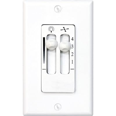

This is all new construction - sheet rock just went up. There are two rooms that are set-up identically. Each room has a fan - with no light - and can lights in the ceiling. A single gang box with a combo fan/dimmer controls both the fan and the lights. One 20amp 12-2 comes into the wall switch box and wires to the switch which then feeds the 12-2 going to the fan and the 12-2 going to the can lights.

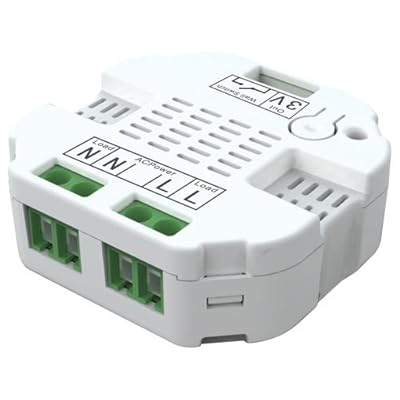

The best case I see would be to put a ceiling fan control in the canopy and a micro dimmer behind the wall switch. This should allow me to control the lights with the hard switch or ST, right? As far as the fan, I’d love speed control with ST, but I’d settle for simple on and off and control the speed with the pull chain. I have complete access to the fan - as it isn’t mounted yet but the only access I have to the can lights is at the signle gang box. The fan control is fairly big so room might be limited although the box is a deep model. I’d prefer to NOT cut in

So a micro-dimmer in the wall box and a fan controller in the fan shroud isn’t an option?
Sure, you can do that, but then you don’t have a wall switch for the fan. I like having a wall switch for the fan.
The two devices in two different places options are things that people have almost always used for retrofits because they only have a single gang switch box. Or because they didn’t have a neutral at the switchbox.

Understood. In a case like that, putting one device at the fan shroud makes sense. So then maybe you want the controls in each of the two rooms to be identical.
Also, you probably already know this, but there are some battery operated devices that you can stick on the wall Next to an existing switch if you do want an on wall controller for the micro. That gives you a bunch of additional options, although you are then adding a third device. But you add a third device if you use a handheld remote as well.
That’s a nice device, but once you go with that you won’t want to switch to the Z wave switches because they will feel like they have fewer features. Where if you go from the pull chain to the automated Z wave devices everybody’s going to think it’s a huge improvement.
