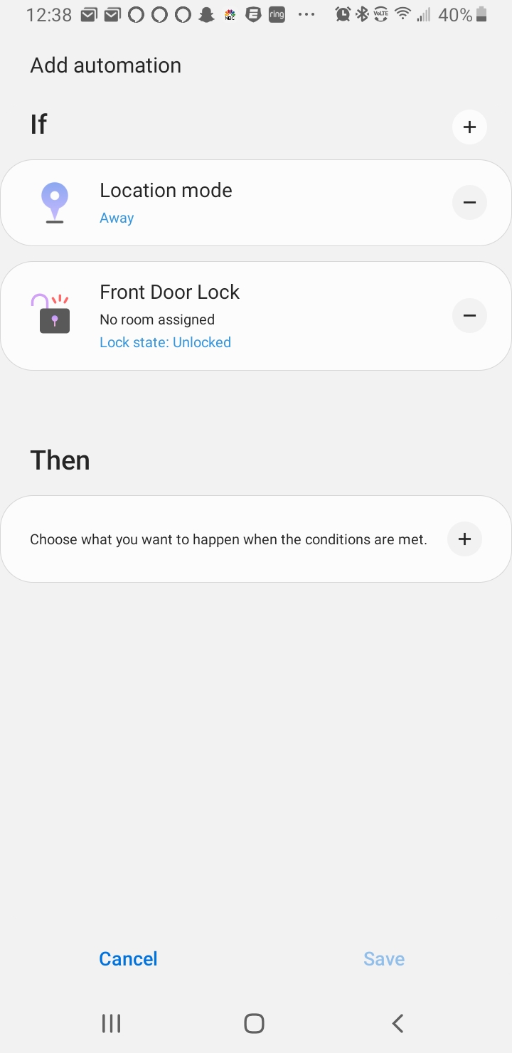

My “I’m home scene” fires inconsistently since the update and migration.
The scenario - if my location is away and my virtual “away delay” switch is off, when my z-wave Yale lock is unlocked then the “I’m home” scene is triggered.
When I say “goodbye” the goodbye scene is triggered which includes an “away delay” virtual switch that stays on for 15 minutes. This is to prevent everything from turning on if we forgot something and reenter the house.
I rebuilt this under the new app.
It won’t fire if I’ve been away for a while. It will fire if I say goodbye, physically turn off the away delay in the app, and unlock the door.
It almost seems as if the device monitor is sleeping after a certain time of inactivity.
I can fire the scene manually so I know it’s good.
I’m about to start troubleshooting it, just checking if there is anything known about this.
Thanks!
I don’t know if I’m understanding the logic for the automations.
For location… Is it as a location changes or the state before an input?
I want it to run the I’m home routine, but only if the location is away and the away delay switch is off.
Now when I add location as a condition or precondition, any scenes that set location are unavailable… This is getting ugly.
Ok… So if your scene sets a location, it cannot be triggered I. an automation that is triggered off of location. The location change has to be set in the automation itself. This has to be broken logic in the automation app or o am completely misunderstanding how to use this.
I’m home, and I leave so I run the goodbye routine which in the routine sets the location to away.
When I arrive home and unlock the door, I want it to run the I’m home routine, but only if the preconditions of location state = away and the away delay switch = off.
Got tired of messing with it.
I created virtual switch called I’m home trigger. I used the smartlight smartapp to automatically turn on the switch when the front door unlocks but only if the location is away and the away delay switch is off. This also can trigger the I’m home routine.
My goodbye routine turns the I’m home trigger off and sets the location to away.
In the smartthings automations when the I’m home trigger switch is turned on, it executes the I’m home routine. Edit - I’ve removed this as the smartlight app can trigger scenes too
This works flawlessly. Now to add in all the other activities back in the routines… Yay. :unamused:
