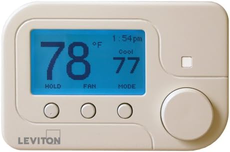

Also found this but not sure about it… Maybe you can contact Leviton and see. Good luck though.
