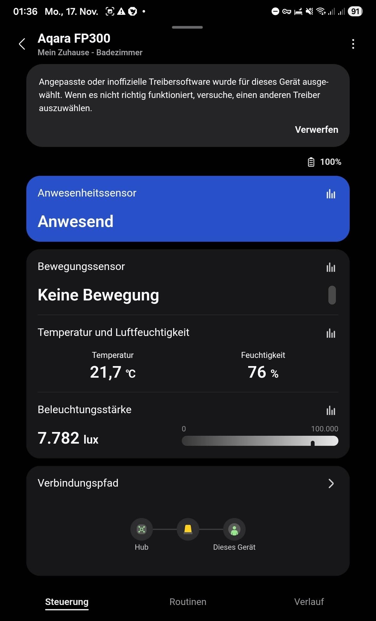

We can configure the device via Zigbee only. Yes, we would need a custom Edge driver. My device is currently stuck again and doesn’t clear the presence. Doing more tests tomorrow to see if it’s a faulty device…
It clears the presence when I switch to PIR only and back to both:

I need to experiment with the settings before releasing the driver, because currently the presence stays stuck for minutes…
Detection is instant:
