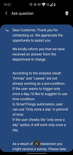

Agreed about support, I asked of them if it was possible to have ‘arrives’ and ‘leaves’ as well as the current ‘at’ or ‘not at’.
So certain automations only happen once (especially with the mode precondition being problematic)…
Their response was:
If everyone arrives and leaves home at the same time everyday I’m sure we wouldn’t even care about presence… But in the real world our families come and go at different times each day.
I may be completely wrong but I can’t see why this would be problematic as they say.
