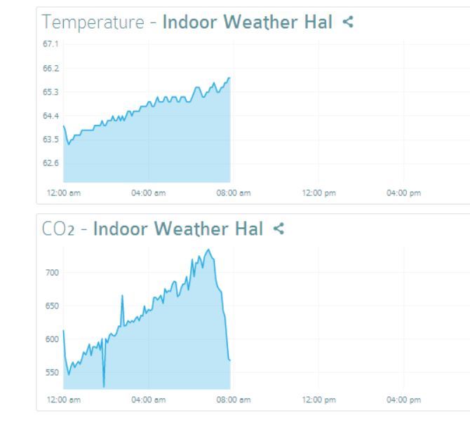

Here you go guys. An app to monitor all that Netatmo has to offer. Try it out and let me know if you see any bugs. Should be working well though
Also shared to the IDE shared apps.

On somewhat of a different subject, check out this site. It hosts the history of your data and give the option to upload the data to WeatherUnderground and a few other weather data outlets.
