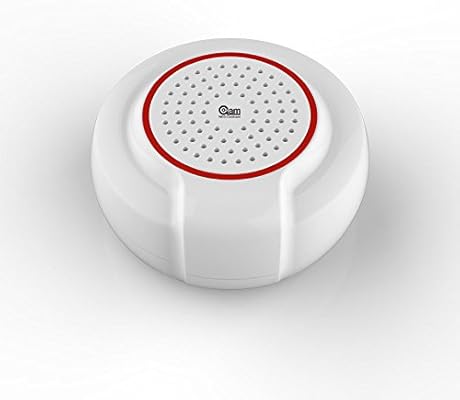

Hi, Has anyone come across this one? Looks good value. Works indoor or outdoor and is battery powered. Looks ideal but i’m not sure how it will integrate with SmartThings.
Fiddling with it right now. It works, installs as a switch, changed to generic siren. Works but hard to turn off and only full “siren” wanted to use it as notifcation (eg soft “bing”) when someone opens a specific door.

Just got one. Worked straight out of the box. It installed as a Generic Z-Wave Switch. I updated to the Dome Siren link above (its not a camera that’s a typo). Gives lots of options for chimes and sirens and I had no problems with distance. All in all happy bunny
Does the Neo Coolcam Siren Alarm works with the custom Dome Siren DH? I got mine (Neo Coolcam SA), successfully detected under z-wave siren. After changing DH to the custome Dome Siren DH, it doesn’t work now. Any clue?
Solved after going thru the setting and click “save” on Smartthings app.

Just got my Neo coolcams Siren working with the Dome Handler published above - very easy!
my original Dome Siren died after about 12 mths of use - I now have a Neo Coolcam Siren (looks identical to the dome)
