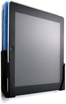

Looks nice @seanvree and no you’re not done, it will never be ā€œdoneā€. What kinda tablet and mount are you using?
@mattjfrank, I know, who am I kidding!
Using a Nexus 7, wall mount:
It’s double stick tape, but I drilled through the back with simple dry-wall screws to make it more secure. Also had to cut a little bit of plastic on the left side so the charger would fit. I like this setup, because it slides in and out really easy.
