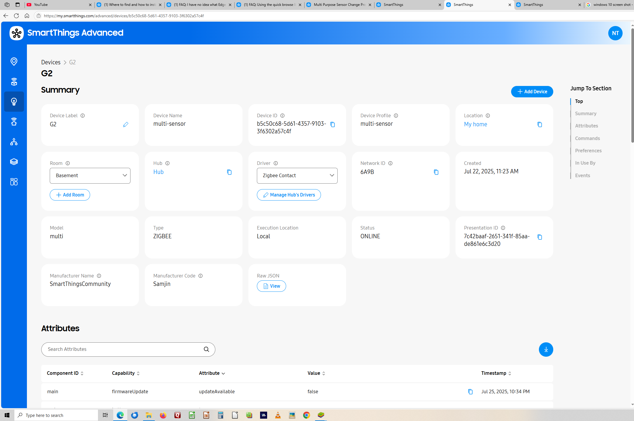

Please go to the ST Advanced Web App and capture a screenshot of the Device Summary info and paste it here.
Thanks. Here is the screenshot
Based on that Manufacturer and Model, the proper driver is the Zigbee Contact and would use the multi-sensor profile which has the contactSensor, temperatureMeasurement, threeAxis, and accelerationSensor capabilities. Can you get a screenshot of the Attributes sections of the device as well please?

This is the screenshot of the Attributes section. Thanks
I figured it out. I found and installed the driver I was looking for and now I am seeing open/close, temp and battery level. Thanks.
