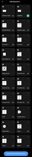

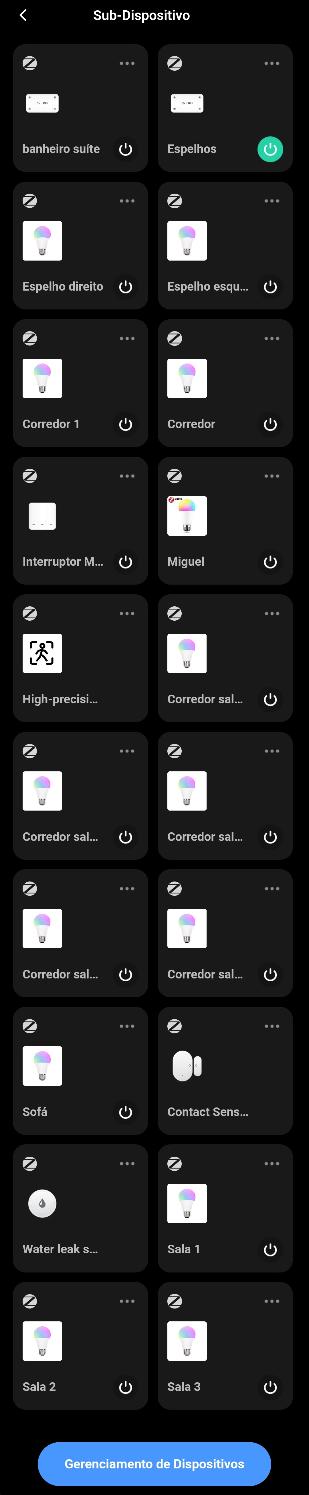

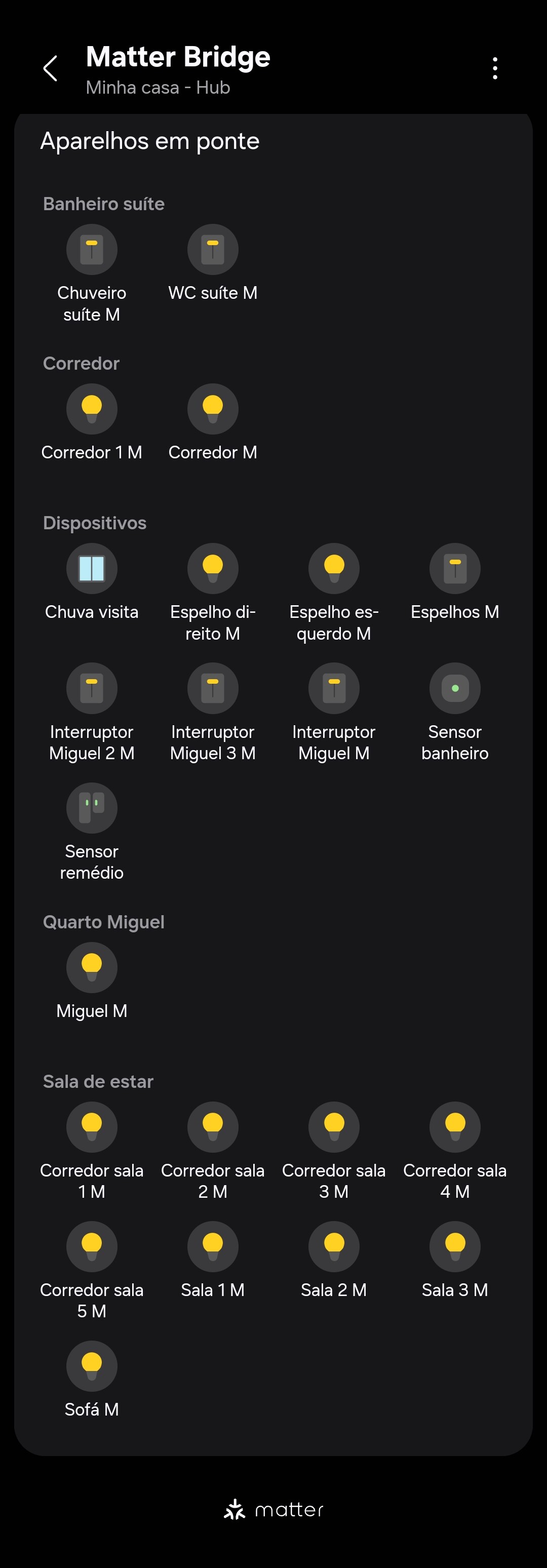

I’m using the Matter Moes hub to export devices via Matter to SmartThings, it’s working perfectly. It’s a great advantage to run groups of lights and some automations in the Tuya app itself, in addition to avoiding overloading the ZigBee network of Tuya presence sensors. All these devices send to SmartThings via Matter.

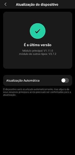

What firmware is your Gateway running?
The Zemismart hub started updating to the new version, which allows exporting ZigBee devices via Matter, but it was probably interrupted by a bug. Moes always releases the updates a few weeks after Zemismart.
That is the same version that I have had since July 30, 2024.
I was hoping there was a newer version.

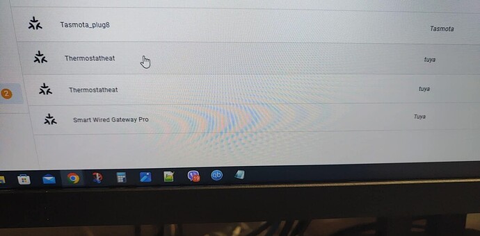

I only have a few virtual devices and a thermostat that I wanted to try.
I shared it as a hub matter with smatthings and it added easily, but it didn’t share any devices.

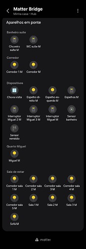

Is your Tuya Matter hub from Moes or Zemismart? To export via bridge, you need to restart the SmartThings hub and then the ZigBee devices will appear in the SmartThings app. Not all of them, but from the tests I’ve done, the vast majority are exported.

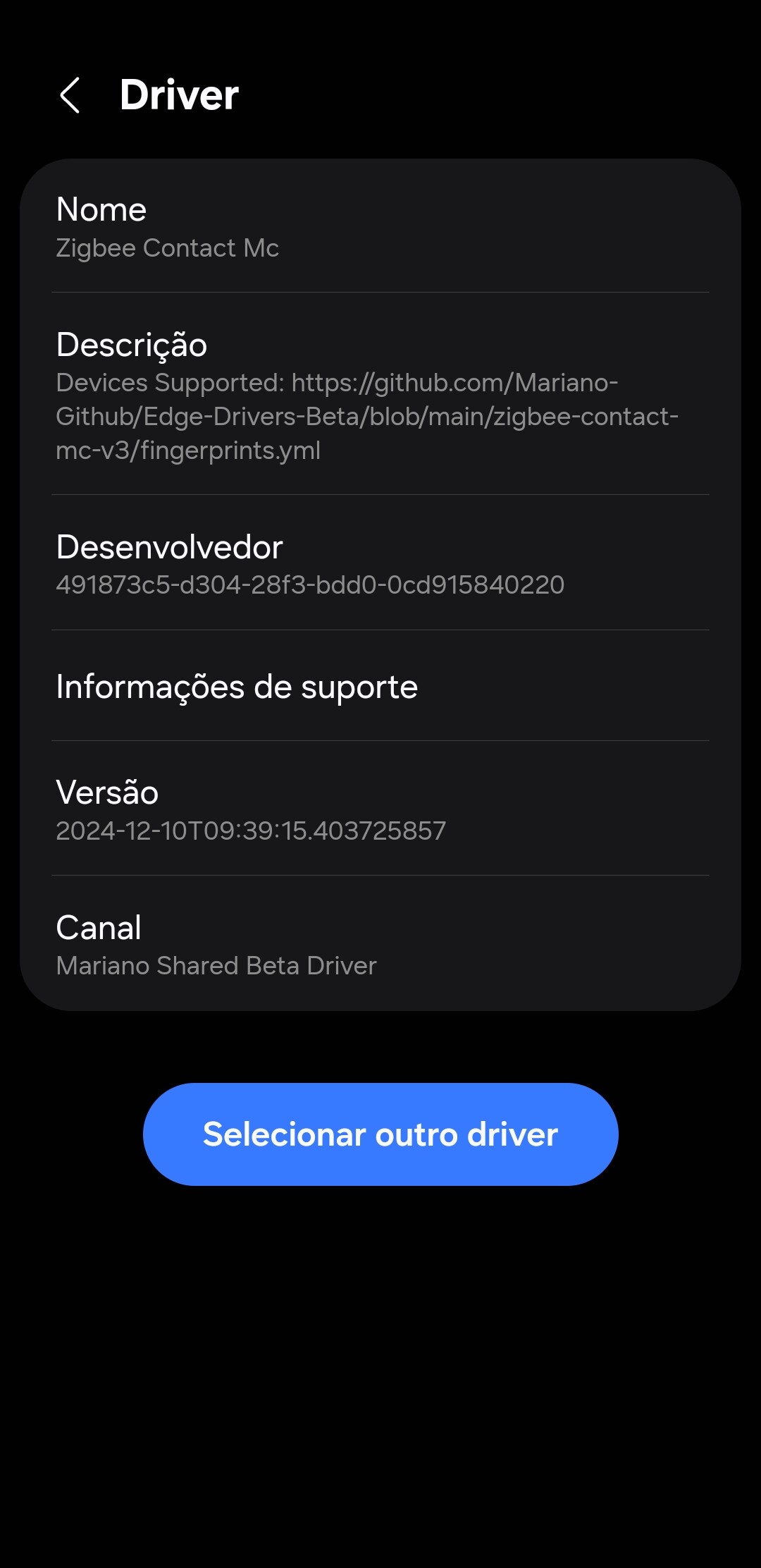

By the way, can you tell me why the Xiaomi contact sensor doesn’t appear in the panel option to appear as offline, without battery, etc.?
As @higorchv said, I always need to reboot my ST hub to get new the bridged Tuya devices to show up in ST.
I have also needed to reboot the ST hub to get the bridged devices to show up.

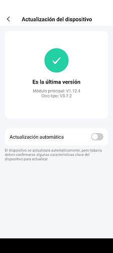

Additionally, the 1.11.0 hub firmware corrected the issue of devices being removed every time the gateway hub was rebooted.

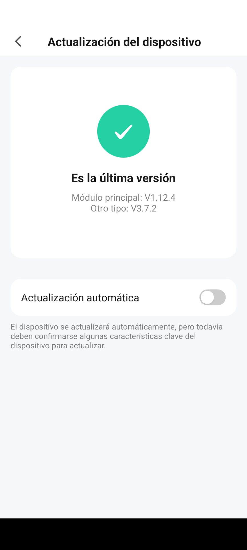

If you can, do not install the version 1.12.4 since in the logs every minute goes from online to offline and vice versa and of course also the devices connected to it
Thanks for the heads up Tuya told me that Firmware 1.12.4 had been pulled. Their reply:
“The firmware 1.12.4 has been taken off, we will launch 1.12.6, please wait some time thanks”
