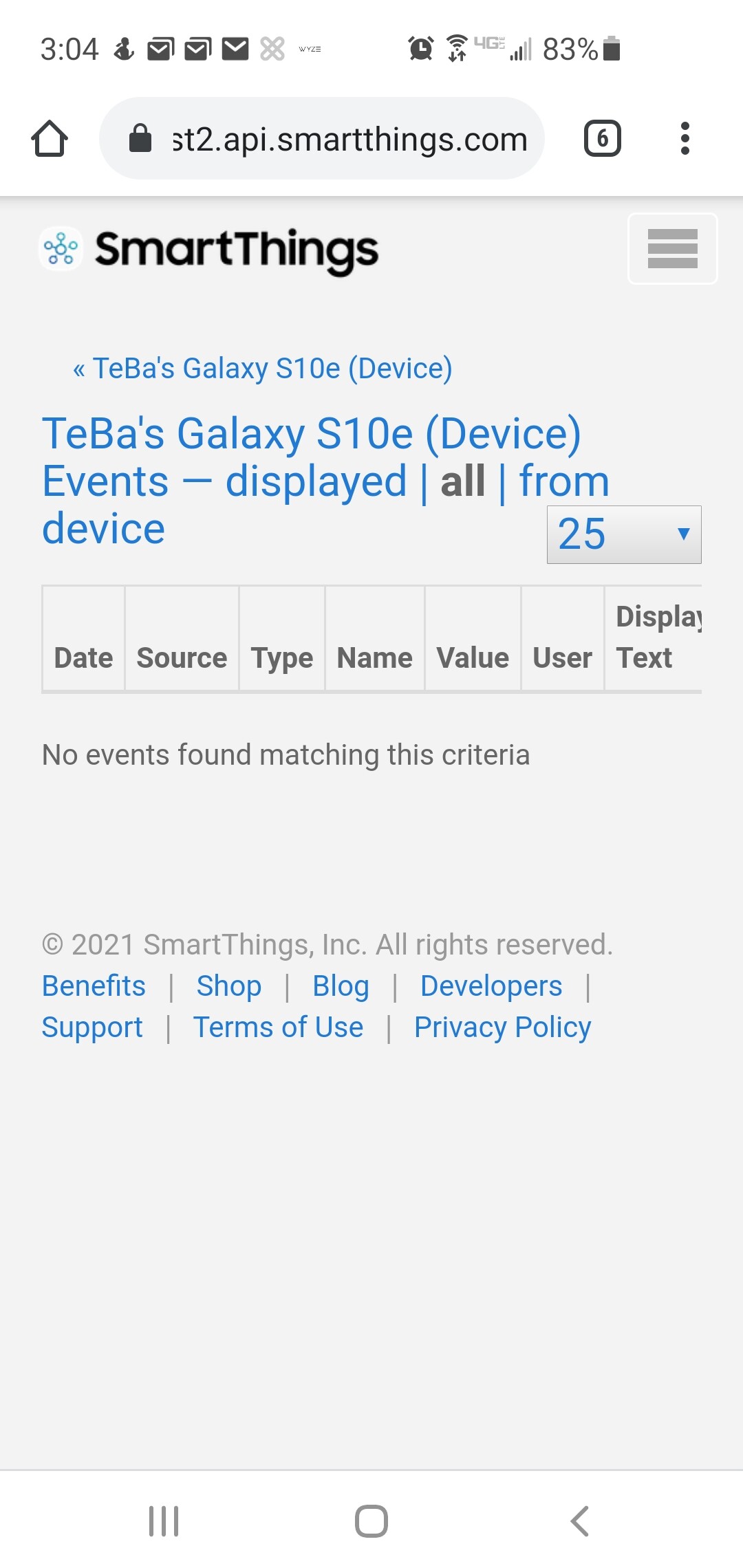

Where do I find the mobile Presence events in the IDE? When I go to the device (my phone) and click on events there is nothing displayed.

I don’t have any events. I’m not sure if it makes a difference but my phone is listed as a placeholder. Do I need change the device type or leave it as is?
The placeholder device type is correct. It is a ‘new’ integration that doesn’t use a DTH being accessed on a legacy site, the IDE, that expects all devices to have one.
The events should still show there if your phone is actually producing them.
This is what I see when I open the device events list. I have it linked to a virtual presence sensor via WC to show status in app. It constantly marks me away when I haven’t left the house all day. I updated the WC piston to check every 30 seconds which has helped.
