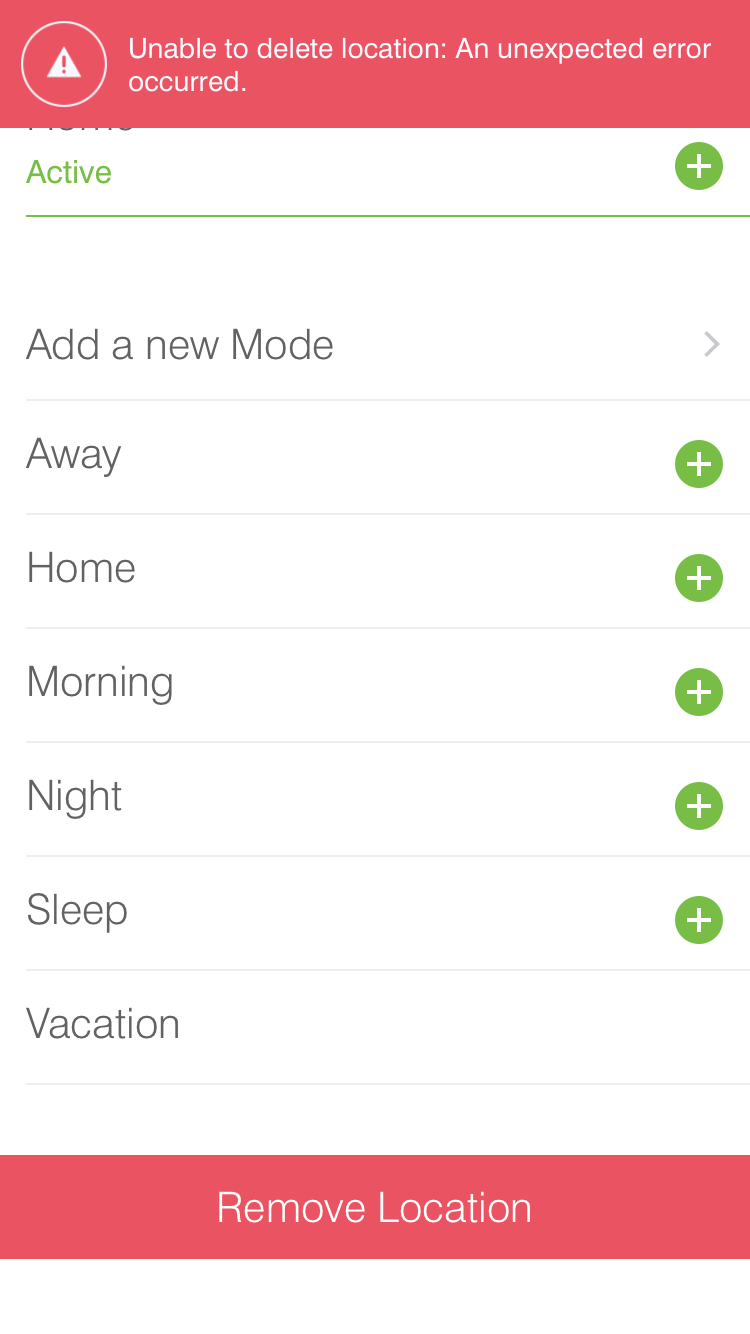

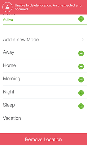

I already deleted the 50+ devices and have the ā€œcannot remove locationā€ bug. I set aside time this weekend to finish the three nights leading up to this removing devices and connections.
Sent a support ticket and figured they’re closed this weekend. I did get a partial bundle deal so I’m not too upset (thanks slickdeals for f#cking up the initial customer bundle – although custom coupon codes which other companies have done would have avoided that). I’m going to hold my breath and just use the DELETE ME renaming method since we have no sensors and theft has gone through the roof in the area.
Fingers crossed. :flushed:
No worries about the old location that you can’t delete. It has no hub connected to it, it is meaningless.
Just set up a new location with a new name, and then you are good to go with your new hub at that new location.
Someday, you will be able to delete that old location. But, it doesn’t matter for now.
