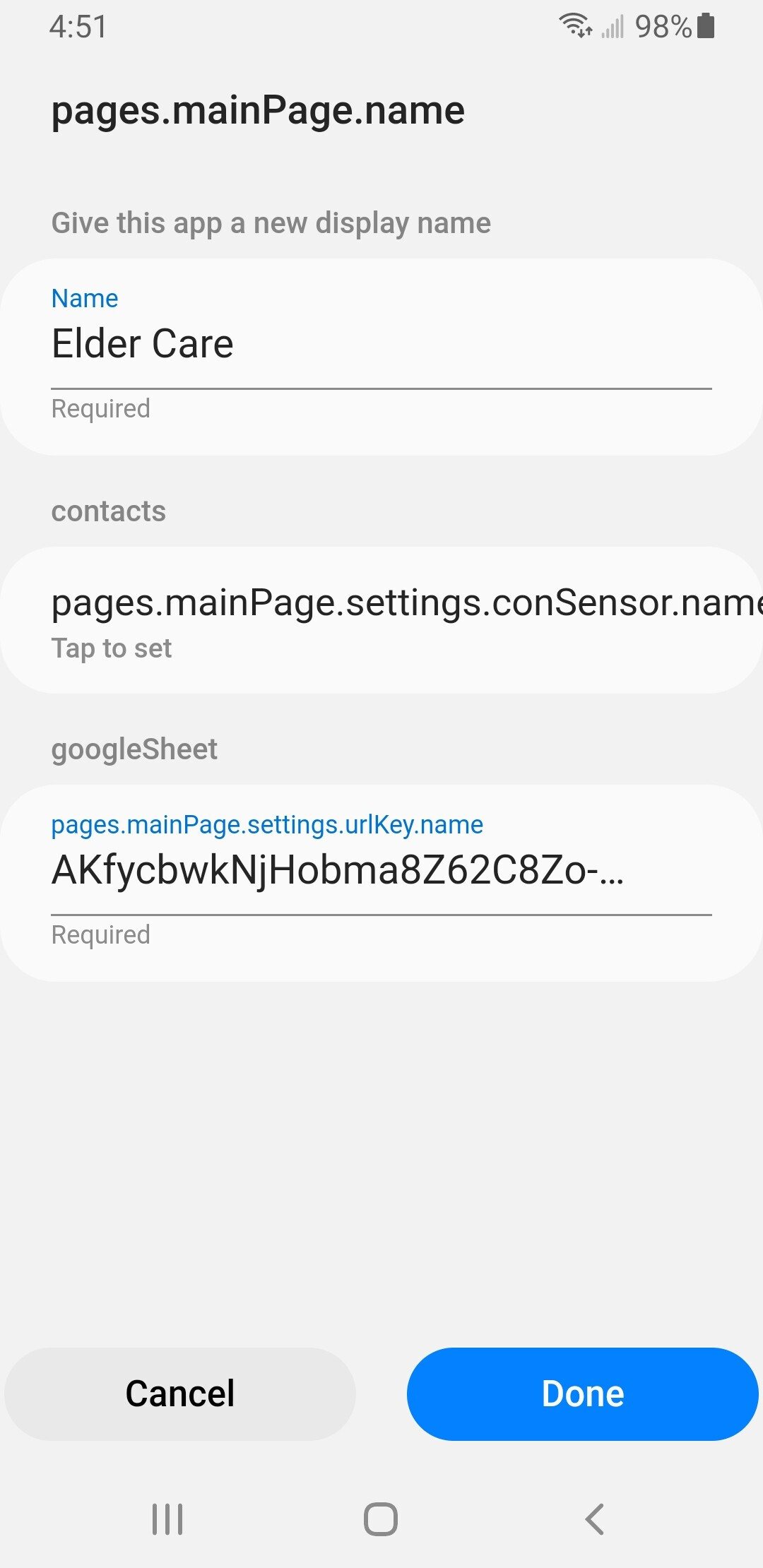

I opened the smartthings app on my Samsung and installed the App called Elder Care
I got these errors (see screen shots) but opened the smartapp Elder Care anyway and got the other screenshot that says it will never expire.
I checked my iPhone to view the smartapp but it’s not there. It’s like what I described earlier about a smartapp shows up on the iPhone but not the Samsung. This time it’s the other way around. I installed the app on the Samsung but it doesn’t show up on the iPhone. I’m logged in to the same account on both phones. What do I need to do to fix the problem of smatapps not showing up on both phones.

Here are screenshots from iPhone and Samsung

That was just for testing, the original SmartApp asked you to introduce the key in that setting. This means that, when you open the SmartApp, you need to type it in the setting that says “urlKey”.

ok, in the code I shared, you can see this line:
section.deviceSetting(‘conSensor’).capabilities([‘contactSensor’]).required(false);
What it does is that, when the app executes, it shows a field for you to select one device that has the capability “contactSensor”. If you add .multiple(true) as below, it will let you select more devices.
section.deviceSetting(‘conSensor’).capabilities([‘contactSensor’]).multiple(true).required(false);
Please, share how many devices you’re planning on selecting.

The credential I’m trying to enter is on the iPhone smartapp. It’s a popup window when I click on the smartapp.
I entered the key on the iPhone in the smartapp that’s on the iPhone. It’s the key that came from the Google sheets URL.
Ok, so, have you verified the request sent to save the data is correct? That is important to verify the functionality. What happens when you save the SmartApp and there’s an event in the device? Does it get registered in the sheet?
Also, about this, sorry for the confusion, what I meant before is to avoid using the other page to install SmartApps, not to share screenshots.
