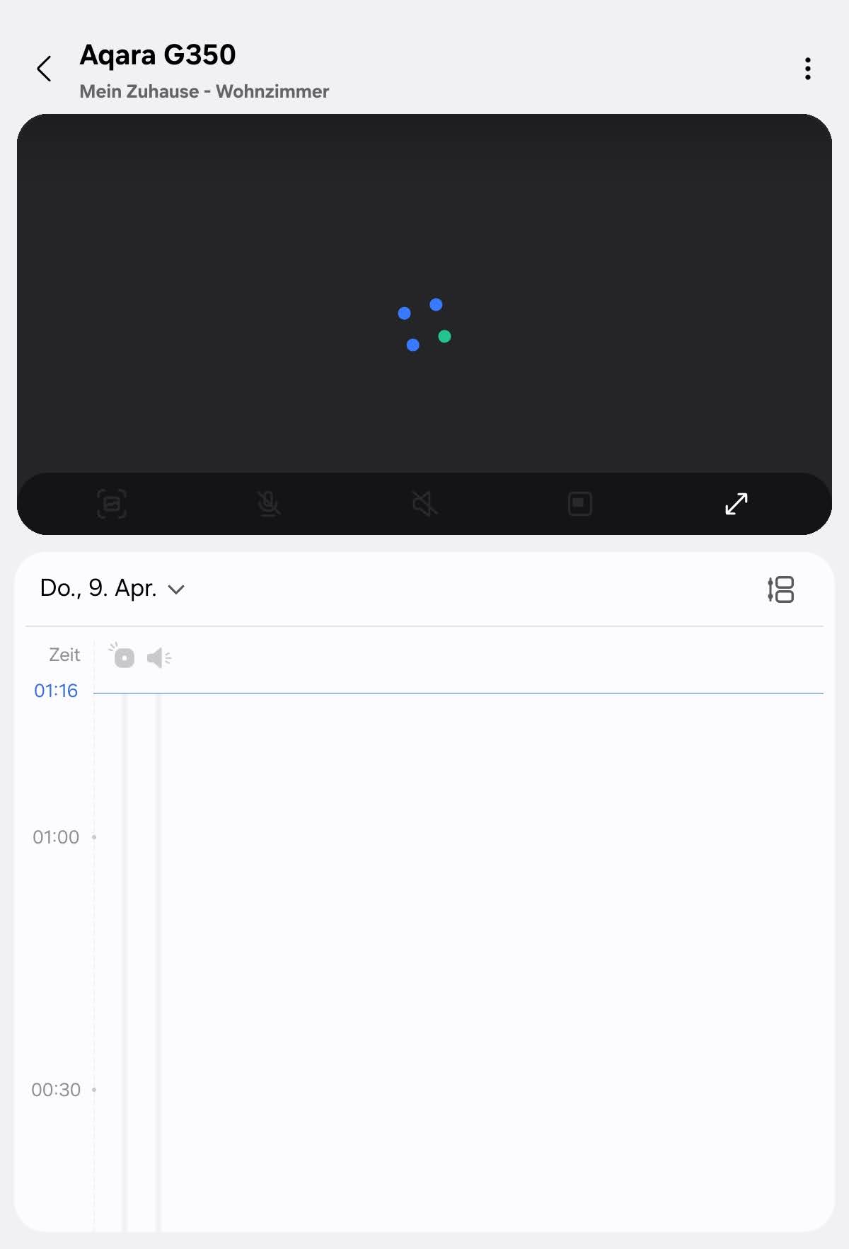

However, the actual UI in the SmartThings app is still very minimal.
Instead of a richer camera page, I basically get a very basic detail view:
This is how it should look like:

It’s the screenshot after adding the Matter camera for the first time.
The first one is from a custom driver you created, correct?
No. It’s the stock Matter Switch driver (current production version). Hours later, I forked it to fix and report a serious issue (GitHub) and later I was trying out different profiles to see if I could fix the presentation. The camera is currently - since yesterday, when I gave up - back on the stock Matter Switch driver.
I’m also in contact with the author of this article who was trying to log in to the AWA to take a screenshot for me from the summary section, but the AWA was broken at the time:
So yes, the screenshot is from the first time I onboarded a Matter camera with the stock production Matter Switch driver.

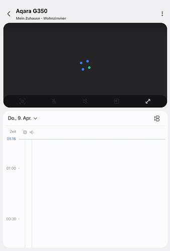

The camera (plugin) works on his iOS SmartThings app (version 1.7.41.12), but not on my Android SmartThings app (version 1.8.45.24 (release)) on Android 16.
The camera plugin(?) version on my Android device is 1.8.46.3:
Interestingly, the tile works:
But the stream won’t load in the device details:
The streaming works fine with the c2c integration, but not with the Matter device. The exact same plug-in also works with my Aeotec Cam 360 cameras.

This improves the device state and diagnostics quite a bit. But the important part is:
Streaming still does not work in the SmartThings app.
The app still just shows the endless loading spinner in the camera plugin. There is no useful error message, no failure reason, and no indication whether the problem is WebRTC negotiation, ICE/TURN, SDP, codec negotiation, stream allocation, firmware behavior, or the camera plugin itself.
Could SmartThings please add a more meaningful error message to the camera plugin?
The spinning wheel is not useful for users, and it is even less useful for debugging. Even something basic like:
WebRTC negotiation failed
No SDP answer received
ICE connection failed
Stream allocation failed
Unsupported codec
Camera plugin timeout
or just an internal diagnostic error code would already be a huge improvement.
Right now, the endless spinner is getting old.
