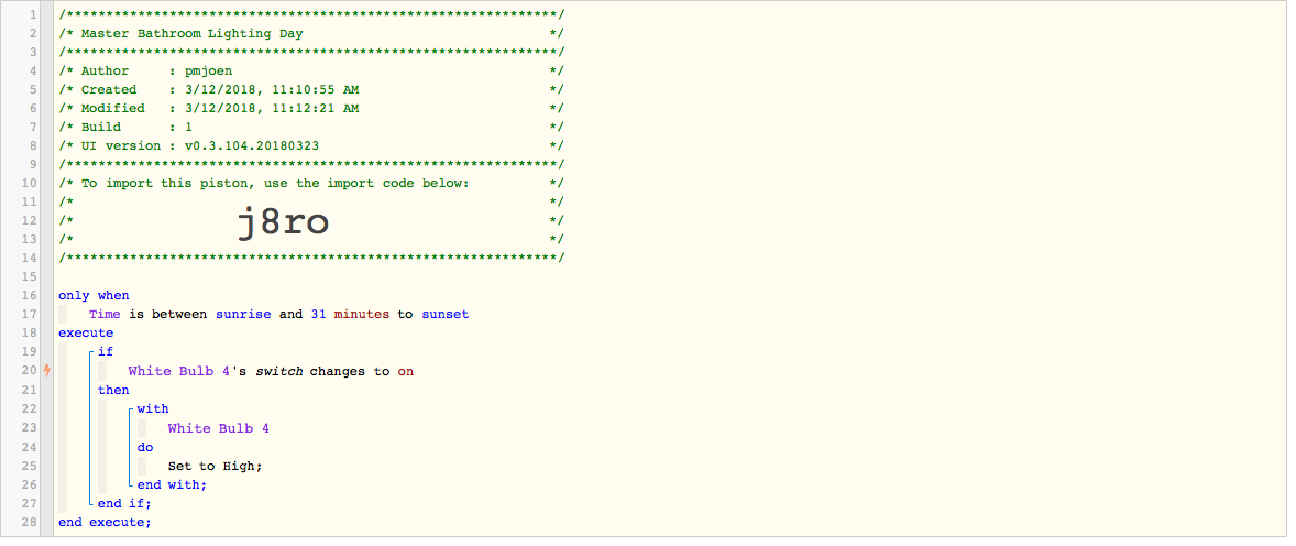

What most of us have done is set up a rule in Webcore so during the day when I press to turn on it will go from whatever value it was to 100%. I only use these dimmers, so we may have to wait for others to chime in.
Would you be willing to share this Webcore code with me? Sorry if I’m asking for a lot here, but I’m trying to best sort my way out of this problem.
