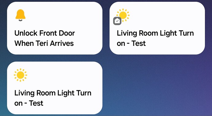

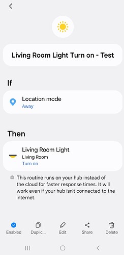

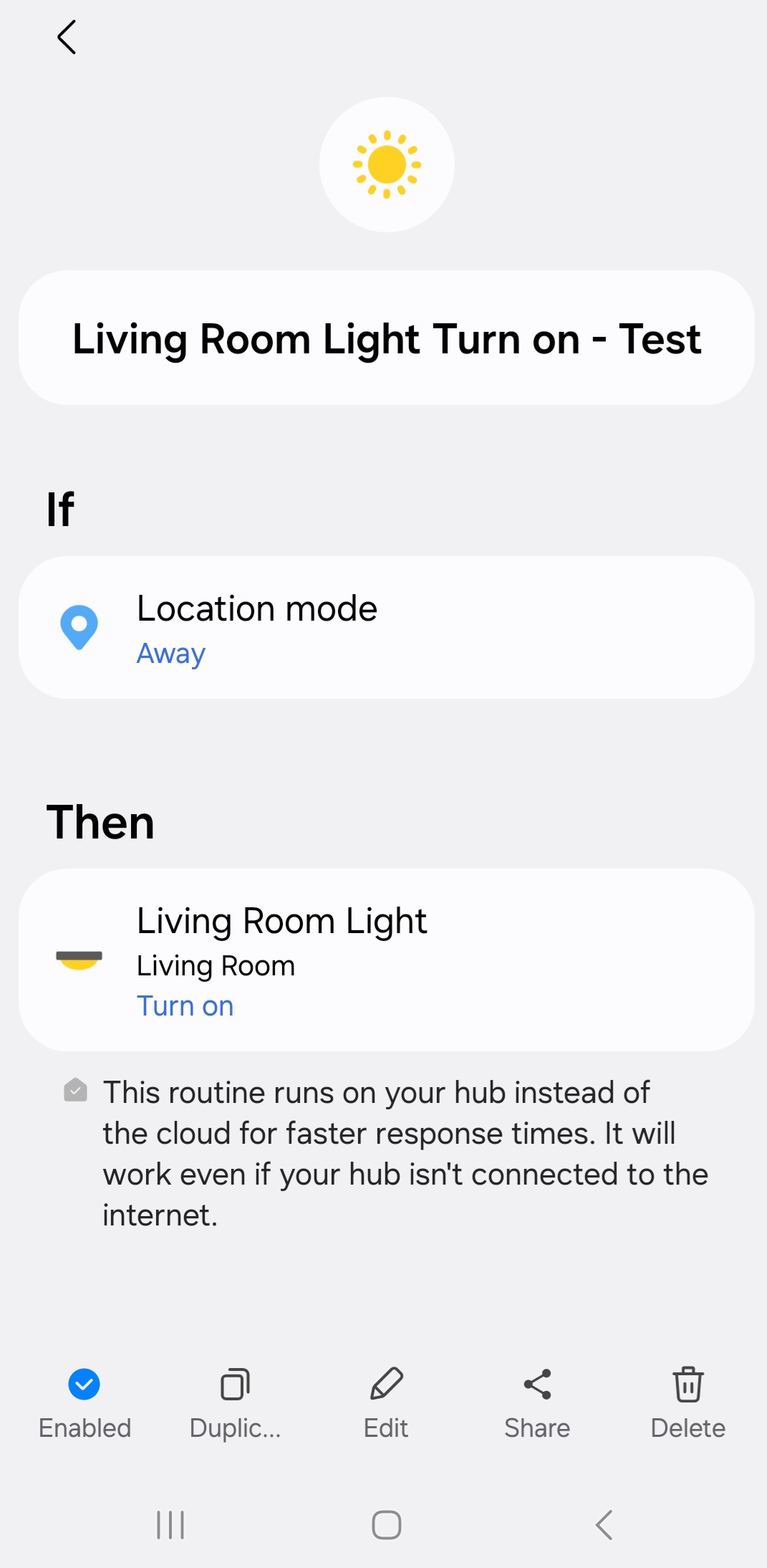

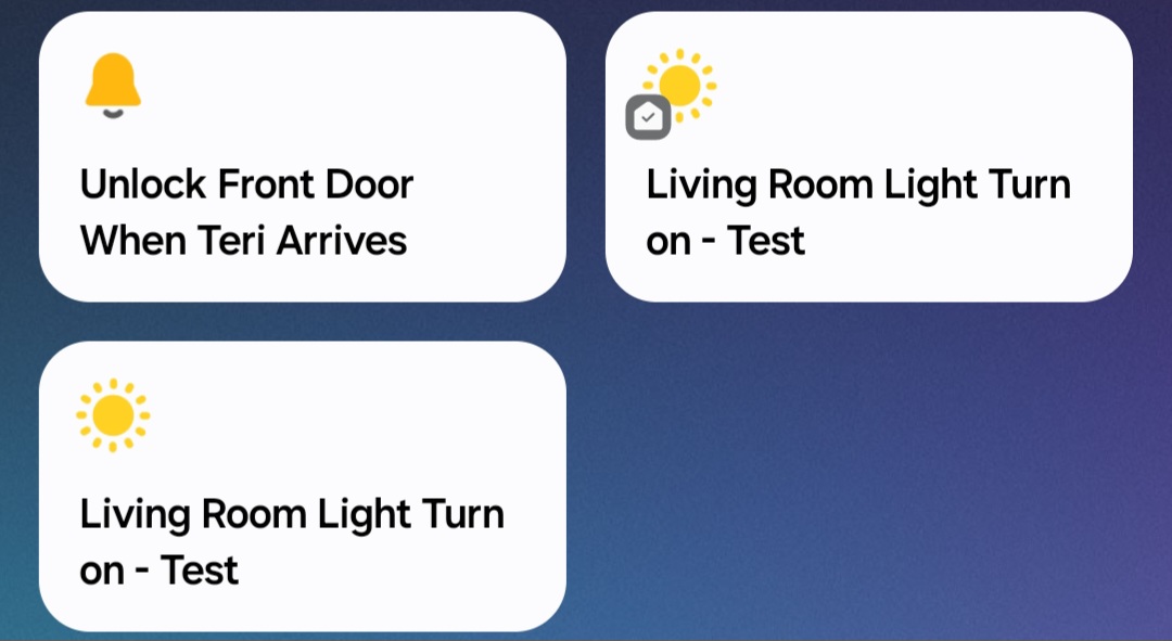

It’s the same as I stated previously, anything in the Routine that can’t be run locally will push the Routine into the cloud. Here is an example of the same trigger, but one with actions that only run locally and one with actions that run locally and in the cloud. You see that one runs locally and the other does not:
