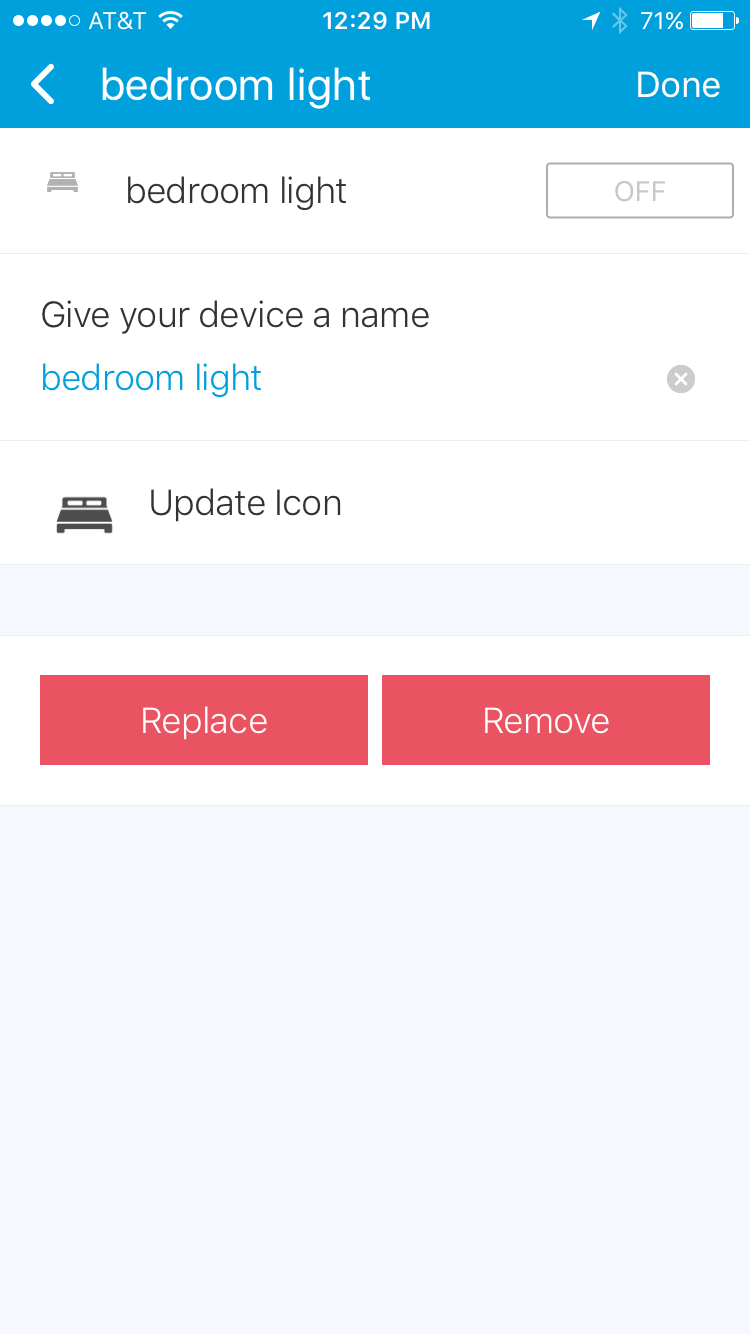

In the device’s preferences screen in the phone app is the easiest. Go to the device, tap on the gear in the upper right corner, and then you can’t miss it. Tap on done.
It just says give name, update icon, remove and replace. Should i have setup the switch through the brands available in Add a thing? If so which brand, Linear is not listed.
