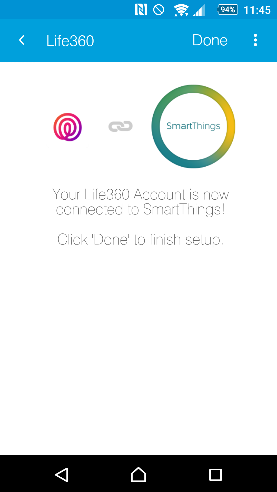

just a quick note for any like me who wanted to use life360 (connect) in the UK, but was getting an Access Denied Error
I got this working by copying the source for the device type and creating a new device type from code
Life 360 User
and creating a smartapp in the IDE from code
Life 360 Connect
I enabled OAuth in the App under SmartApp Settings
and entered my username in the clientId field, my password in the Client Secret field
and entered https://graph-eu01-euwest1.api.smartthings.com in the Server URL field.
I then chose in the Mobile app to add the Life 360 Connect from the My Apps section and then entered my Username and password again and this time the pairing succeded and i can use life 360 for presence which works so much better and reliable than the smartthings app on Windows Phones.
