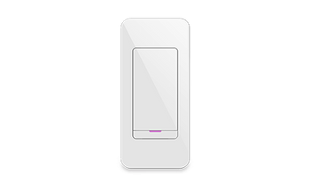

- I haven’t found anything yet about battery switches - what is available? I can make a hole for a socket if necessary but surface mount would be a lot easier to avoid having to cut holes in tiling.
Update: Found the Eaton RF9500AW. Not Decora but is surface mount. Comments in the threads here seem to indicate this might be the only surface mount switch.
