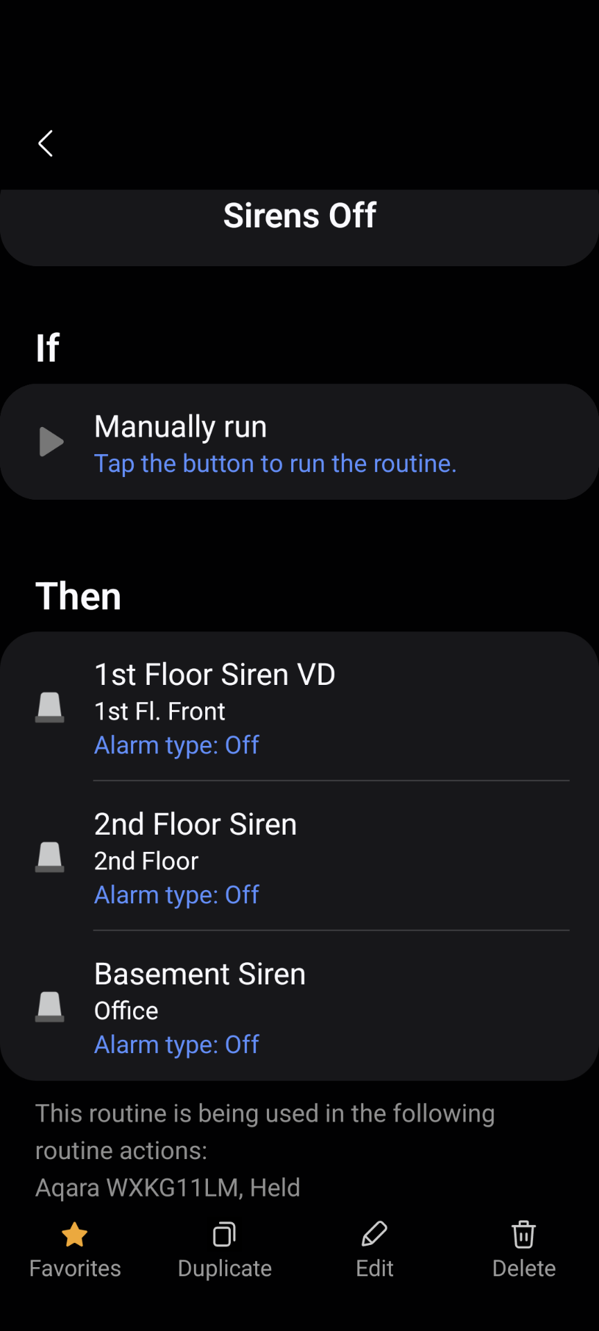

I wonder if it’s possible to create a pin protected tile that at least allows you to turn off the siren until you can dismiss the alarm in the ST app.
You can easily silence you alarms with a routine. But I don’t know about pin protected.
