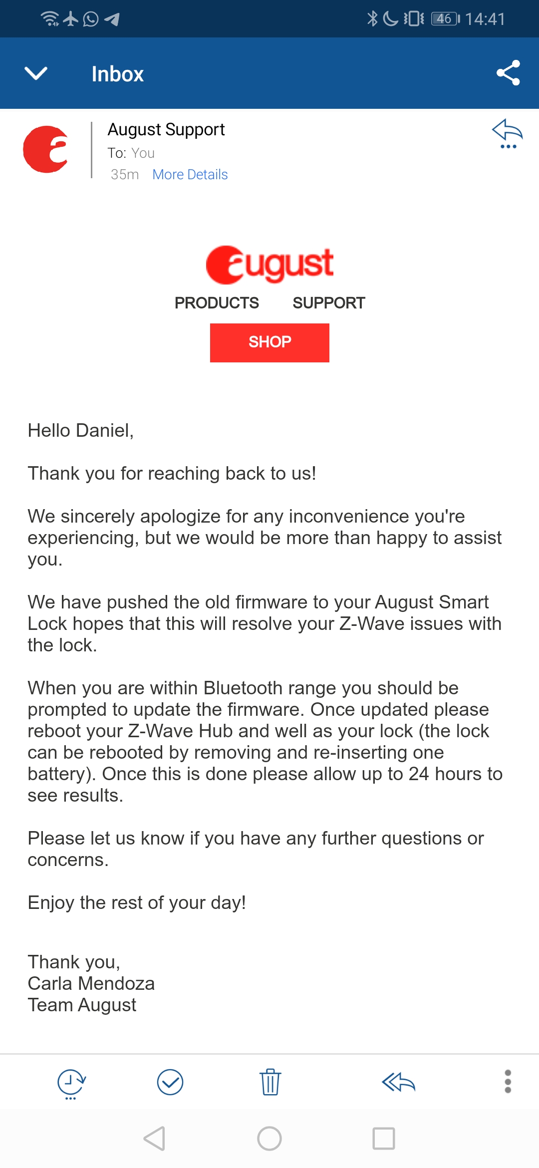

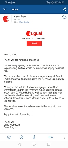

Sent email explaining all I tried (new batteries, restart, removed from z-wave, etc.).
Sent link to this thread.
Recieved email, in hours explaining old firmware would be pushed (for some reason I forgot to write down old one) and got 1.8.15-1.59.0 (why is my firmware in inverted order than everyone else?)
24 hours later: z-wave works as expected and no more battery draining.
