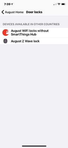

The August WiFi integration is now available for August/Yale locks using August WiFi (August Connect)

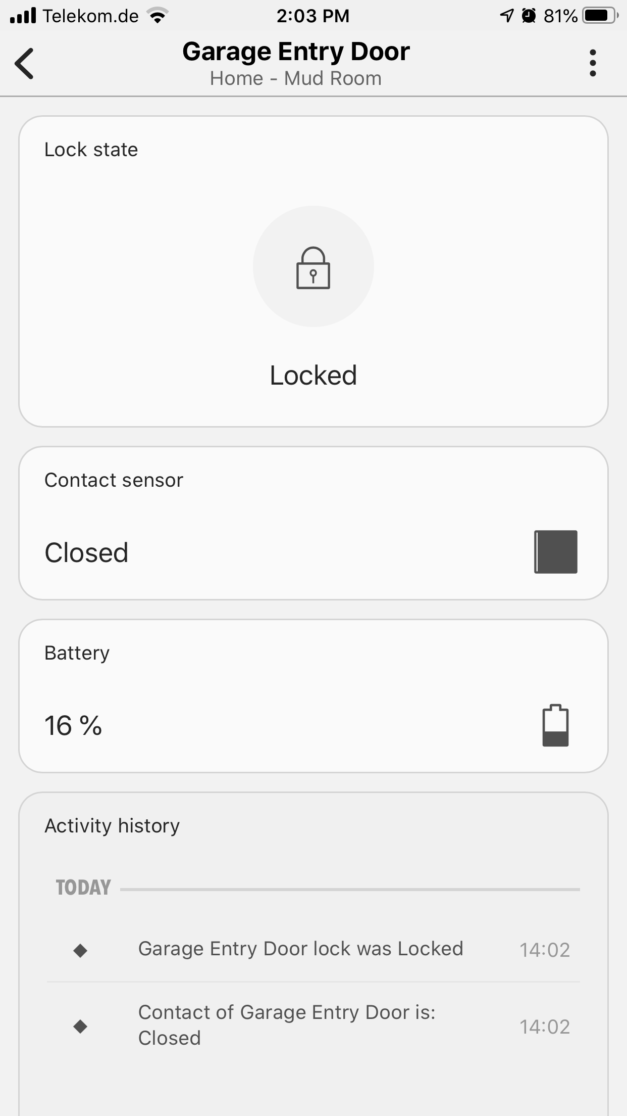

The August Lock’s contact sensor does show on the device and can be used in ST automations and webCoRE

Does this only work for models that don’t have zwave? If not, how do I do it? Looked around in the classic app and don’t see a connection for August. Maybe had to be the new app?
Add in new app and then you can use devices in the classic

Everyones mileage may vary. A z-wave repeater which was recommended for z-wave locks would no longer be needed. Possible that battery life may be extended by not using z-wave on the lock (not verified). I did not use @rboy’s DTH so I do not know what capabilities it offered. I used the stock ST DTH and the battery level did not appear to update (was always 100%) but does look to be working in the new integration. The August contact sensor is available in the new integration which you can use in Automations and webCoRE.
