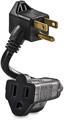

Or just get an outlet extender similar to this.
