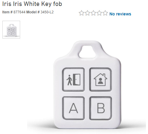

It looks like they may be coming out with a new line of devices with minor changes. Here is possibly a new remote:
https://www.lowes.com/pd/Iris-Iris-White-Key-fob/1000305365
Old vs new

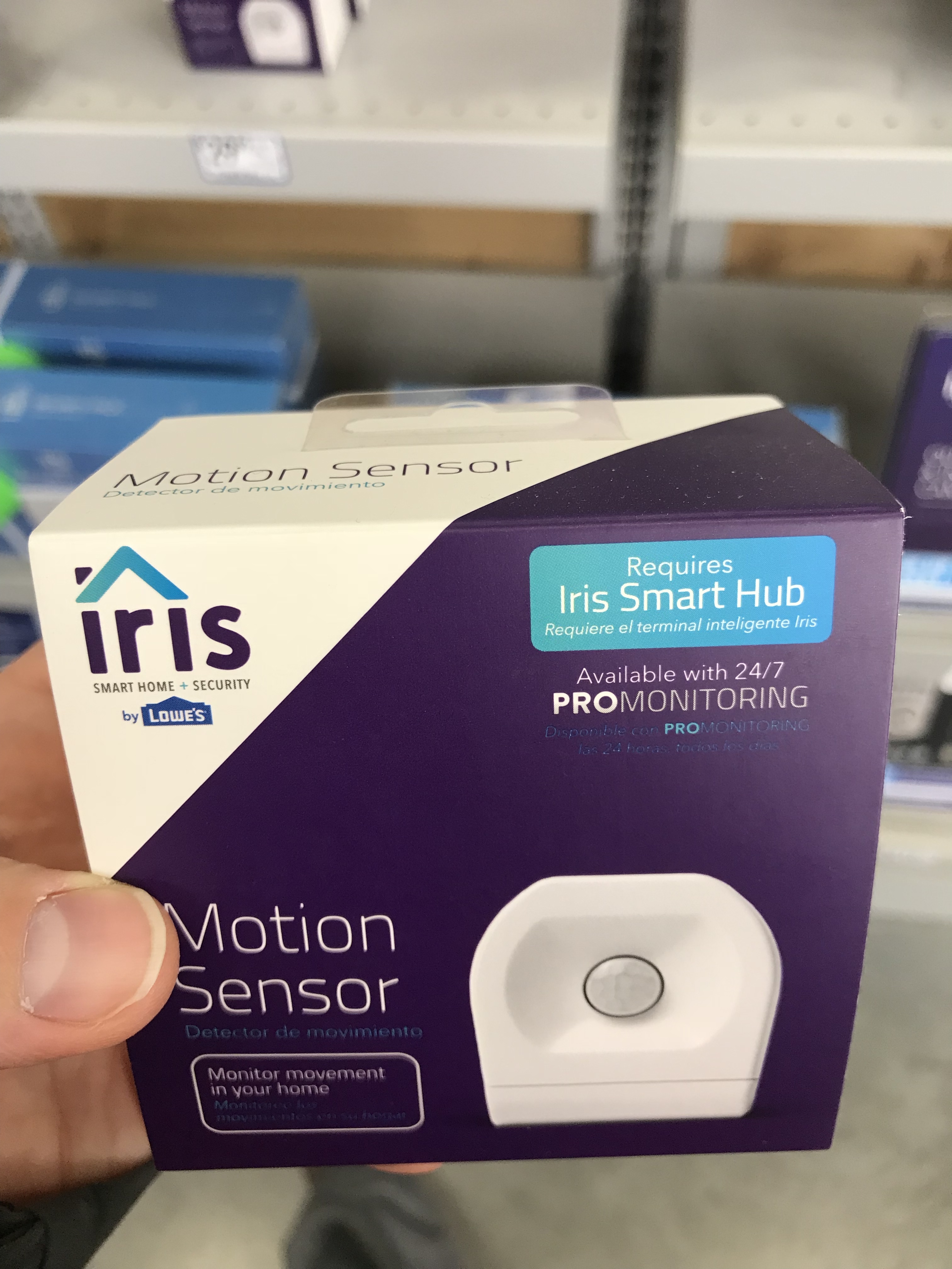

They got the new motion sensors in at my local Lowe’s. Curiously they are $5 cheaper than the old ones. New packaging with a new Iris logo.
So any idea if it works? I was at my local lowes this morn they have a
bunch that they just put out.
Not sure. Have two of the last gen sitting in a drawer waiting to use, so didn’t buy it. It physically looks the same, so I’m guessing it will still work. If they’ve changed the fingerprint you will ha e to manually assign the smartsense motion handler in the ide.
