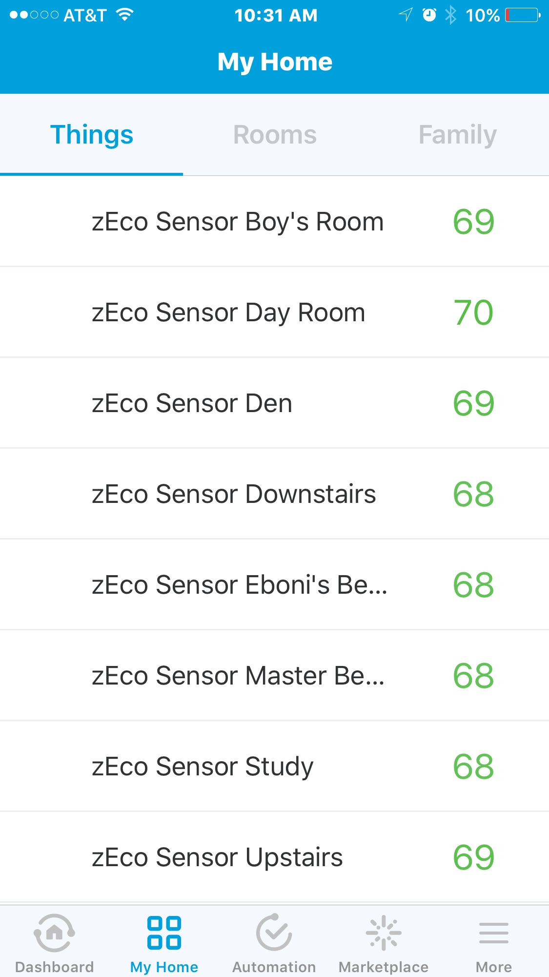

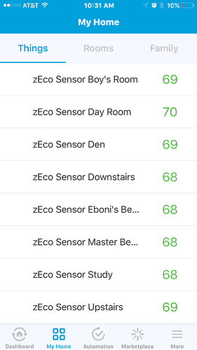

I really wish now that I would have held off on buying so many things at once. I have 8 temp sensors with the Ecobee, 5 with Blink cameras, 10 with Iris contact sensors, 5 with Samsung multi and 5 with Zooz multis…
Only use the Ecobees but could have done without them but they do make life easier. Before it was typical for rooms to be 10 degrees off from each other.
