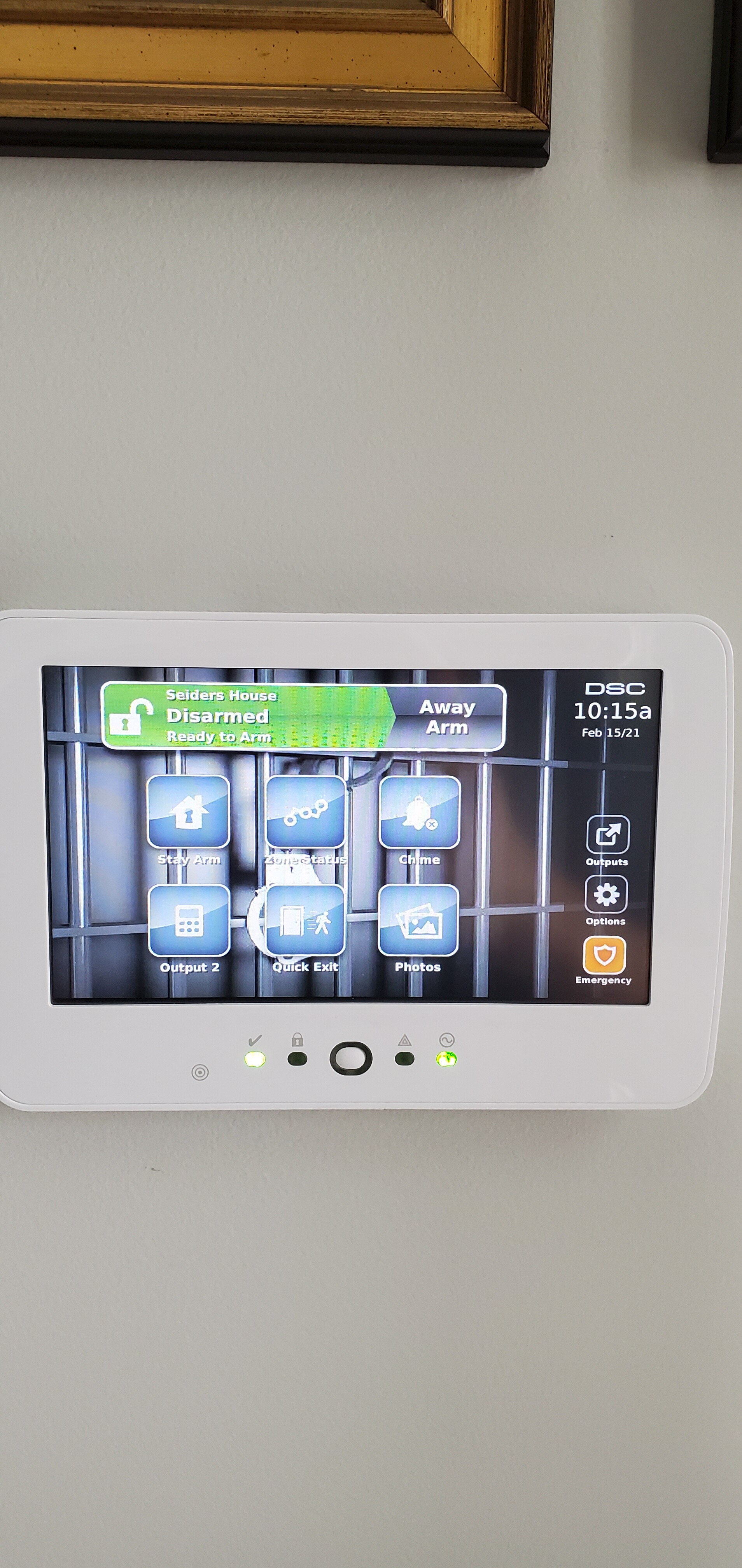

I’m reading this thread deciding how I want to tackle my dsc neo integration.
This is my panel hs2tchp. Anyways I like the new dsc stuff had it almost 2 years. You can add photos for background. LoL anything.
Hoping to get started on this project during fmla from work :slight_smile:
