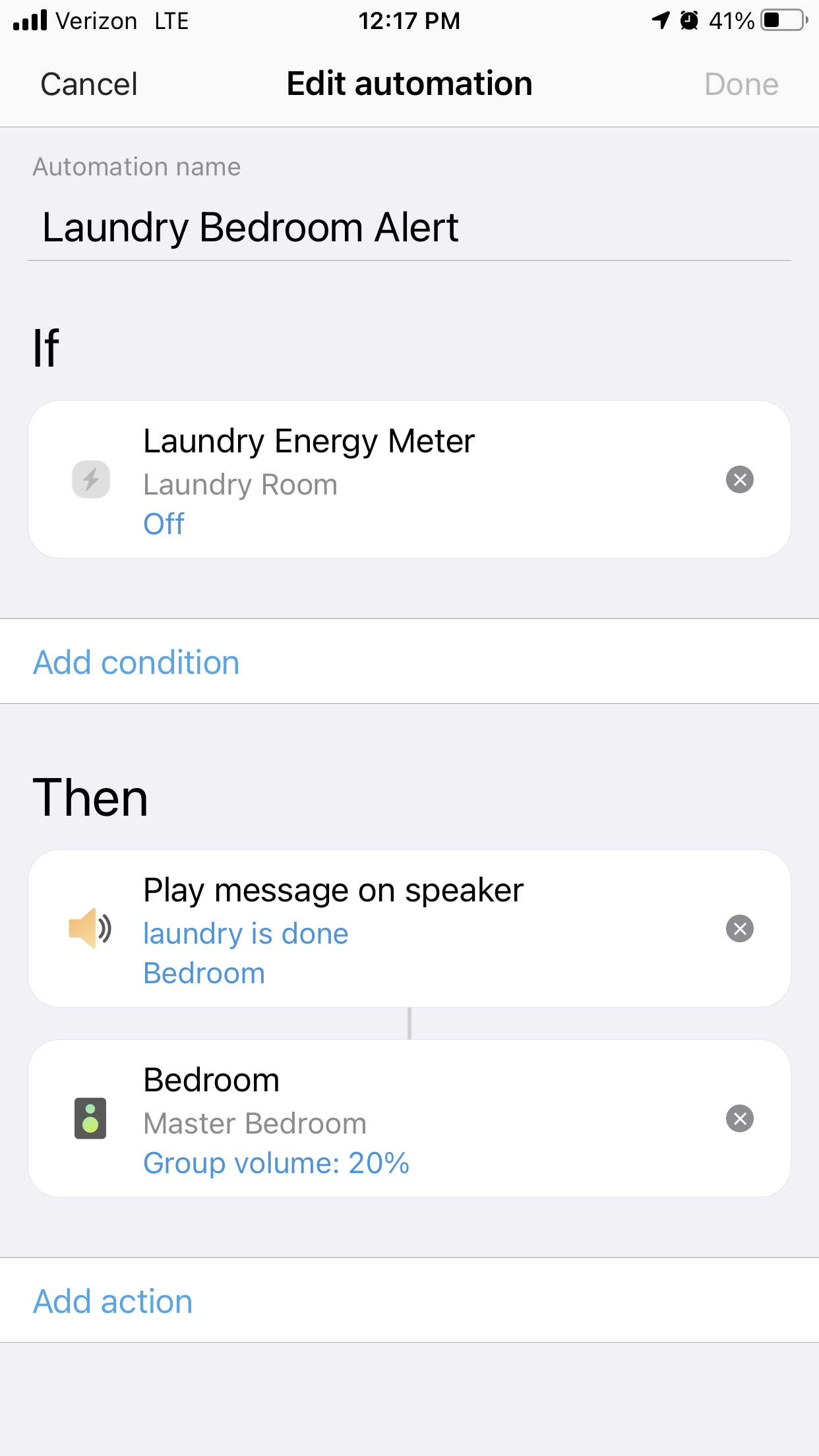

You use STHM or an automation to send the voice alert to the Sonos speaker. And I don’t think it’s single use, it still plays whatever music you want too :grin:
Tagging @TheSmartestHouse
@Automated_House, so does SmartThings have built in audio files or text to speech or what? How is the sound quality, like for music, of the Symfonisk and how loud is it?
As I understand it, the new websocket integration for Sonos generates an audio file base on your text and which voice you choose. It then send that to the speaker every time the automation runs. I don’t have any other Sonos devices to compare the Symfonisk too. I’d say it sounds a little better than my 2nd generation Echo Show 10, but not as good as a bigger speaker like my Denon Home 250, which is to be expected.

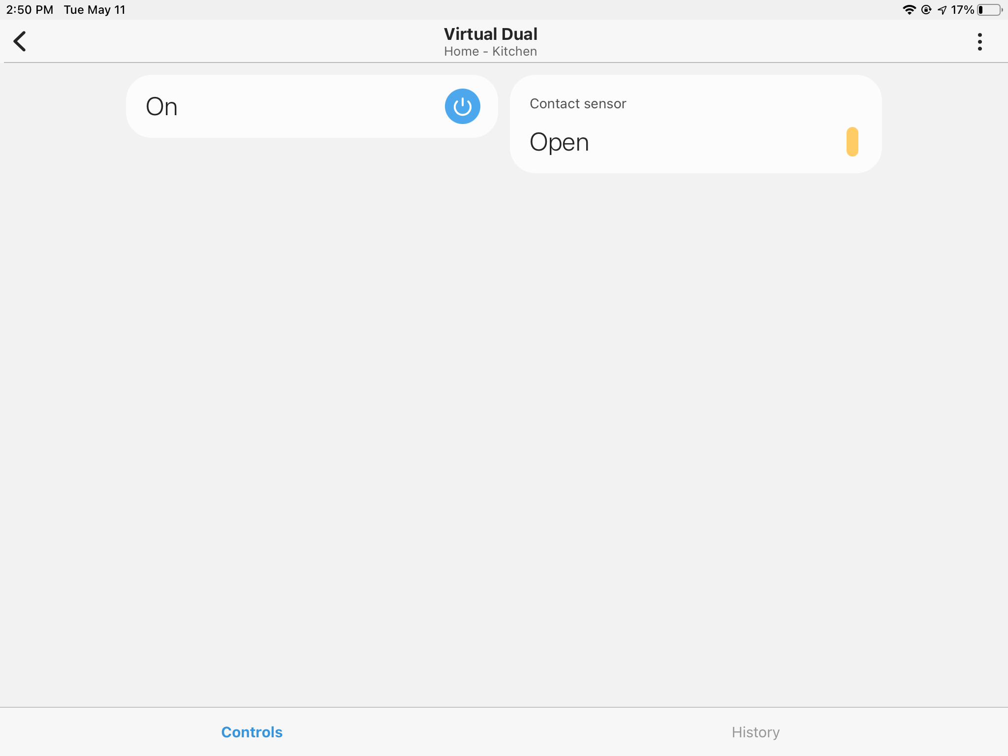

You have to use a very special kind of virtual device which is BOTH a switch and a sensor. When you turn on the switch, it will look like the sensor opened. When you turn off the switch, it will look like the sensor closed. You can’t use just any random virtual device, you must use the code which is linked to from the FAQ.
FAQ: Can I trigger an Echo Action without Speaking to It?
It will end up looking like this in the ST app: one device, which is both a sensor and a switch.
It will look like two separate devices in the Alexa app.
