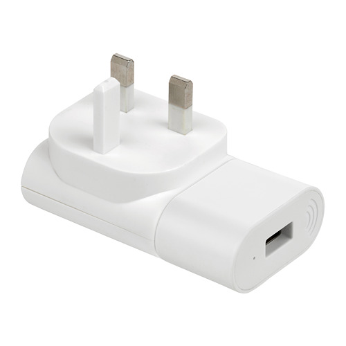

I wonder if the USB charger is anything special like over 2.4a or supporting fast charge…

I just popped into to ikea pick up some outlets and took a photo of the repeater for you
But it looks like its only 1.5a output
