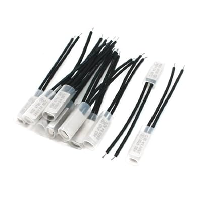

im cheap and like to play. I would connect a thermal sensor to a open close sensor. place it on the outside rear,side, or in the lower storage drawer (touching the bottom) of the oven as it would heat up enough to trip 40C (you could go lower say 30 or 35c and make a rule in rule machine
