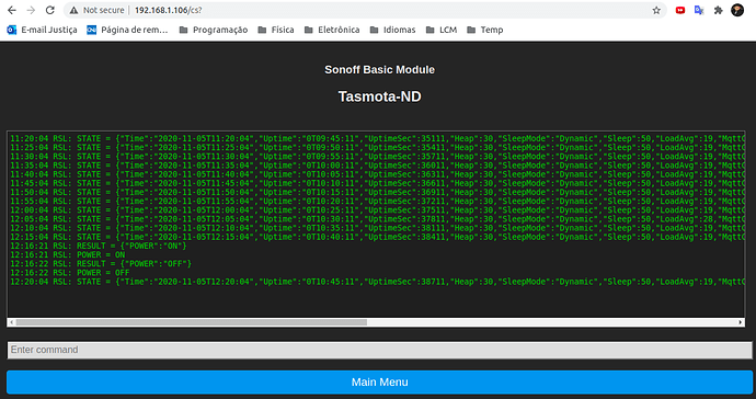

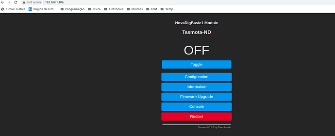

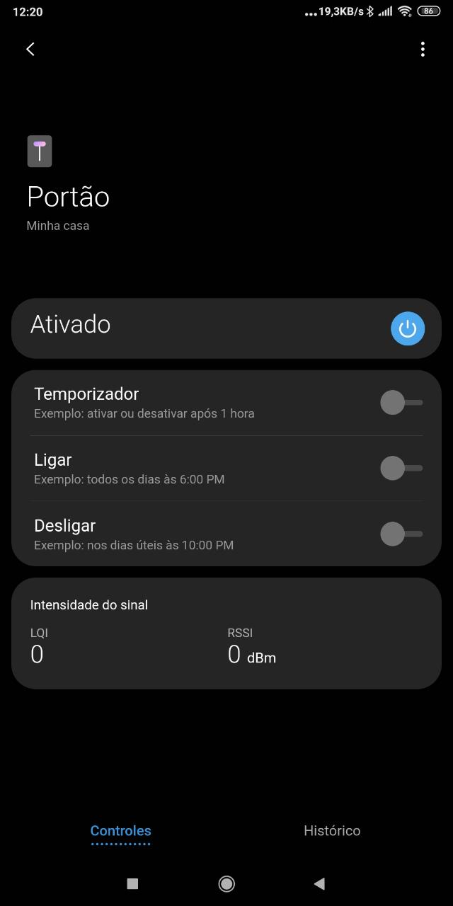

Good night, I’m trying to do an automation using devices with Tasmota firmware, but I can’t access them through the Smartthings app. I’ve seen a Youtuber showing how to do it, but repeating the same steps doesn’t work. The device is normally recognized by Alexa, but in the Smartthings app, through the Tuya-Connect library I enter the device’s IP but it cannot communicate with the device.

Try click “Toggle” and look under Tasmota console, can it do a websend to your ST hub IP address successfully?
If it doesn’t, there is a communication issue between Tasmota device and ST hub.
Is your ST hub (v2 or v3) on the same subnetwork as the Tasmota device?
Do I need a physical St Hub to integrate the smartthings app with Tasmota?
