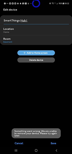

Thanks for the IDE idea. Problem is, I went in there and had two locations. Got rid of the one with no hub, but I show 2 hubs on my account in the app, but not on the IDE. One is the active, one is the inactive creating the flag on the app. Only the active shows on the app. When I try to delete the inactive hub, I get an error mesaage
