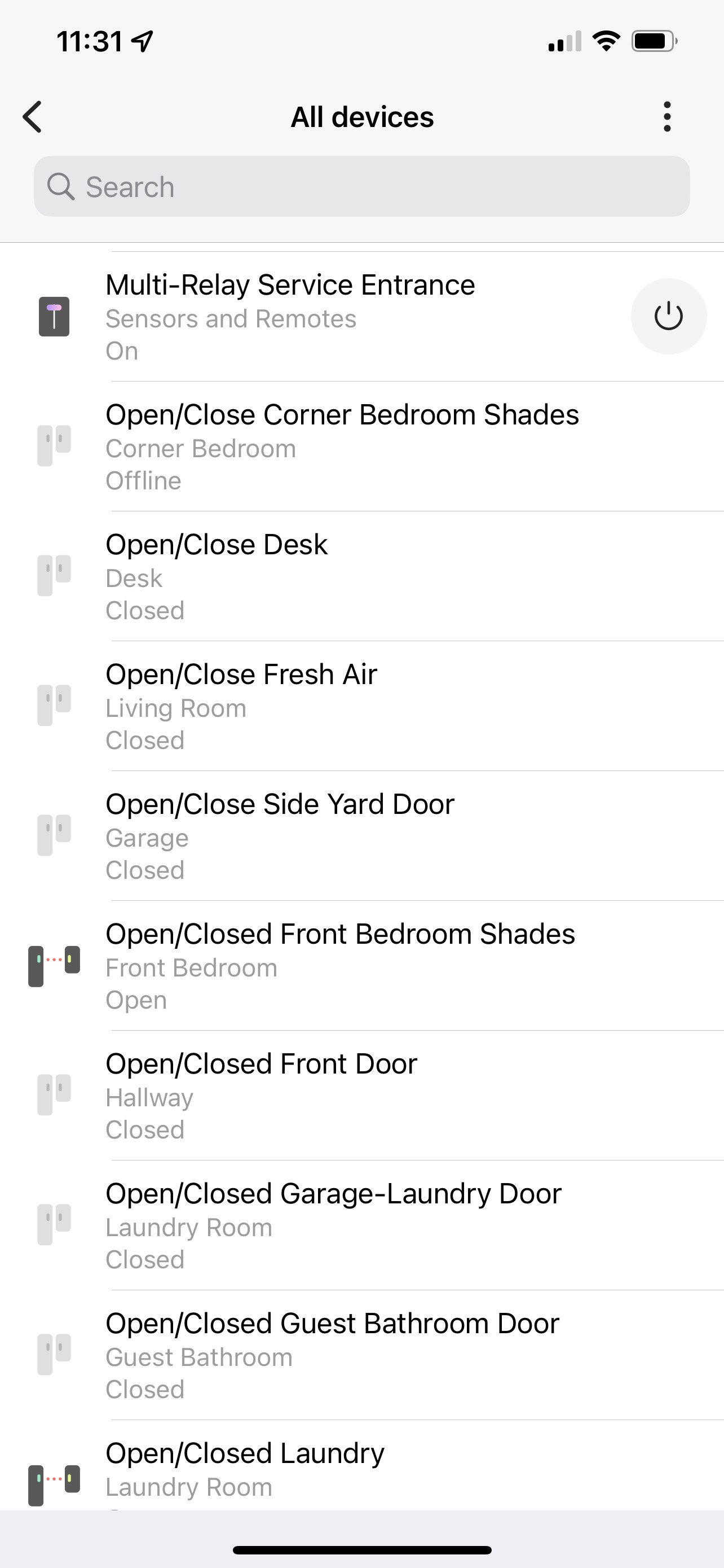

After each new update I checked and the hub still did not show in my device list. With 1.6.73 I can now add new devices from my iPhone, but still cannot see it listed in all devices.
If it is not showing in the All Devices section as you noted and assuming you do not have multiple Locations… only ST support will be able to assist at this point. You noted that you contacted ST support, it you are in a region where calling them is an option, that may get a faster resolution for you.
Once you are able to see your hub in the app, assign it to a room which support will probably recommend.
It turns out the hub was in a room that didn’t exist on your location. I moved it to Bedroom and you should see it now and can move it elsewhere if you’d like.
