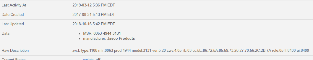

Hi @cbaumler,
I just added a brand new GE zwave plus fan controller (device ID 6D), but it did not register correctly:
It should look like this (right?):
It’s performing really slow and device states in the app aren’t reflecting physical device states/speeds.
EDIT: If I use the up or down arrows, the device will speed up or slow down, but the app won’t update. Physical changes aren’t showing up either.
Those are the actions through the Classic mobile app, and the device did turn on and change speeds, but ST never updated the app or IDE.
