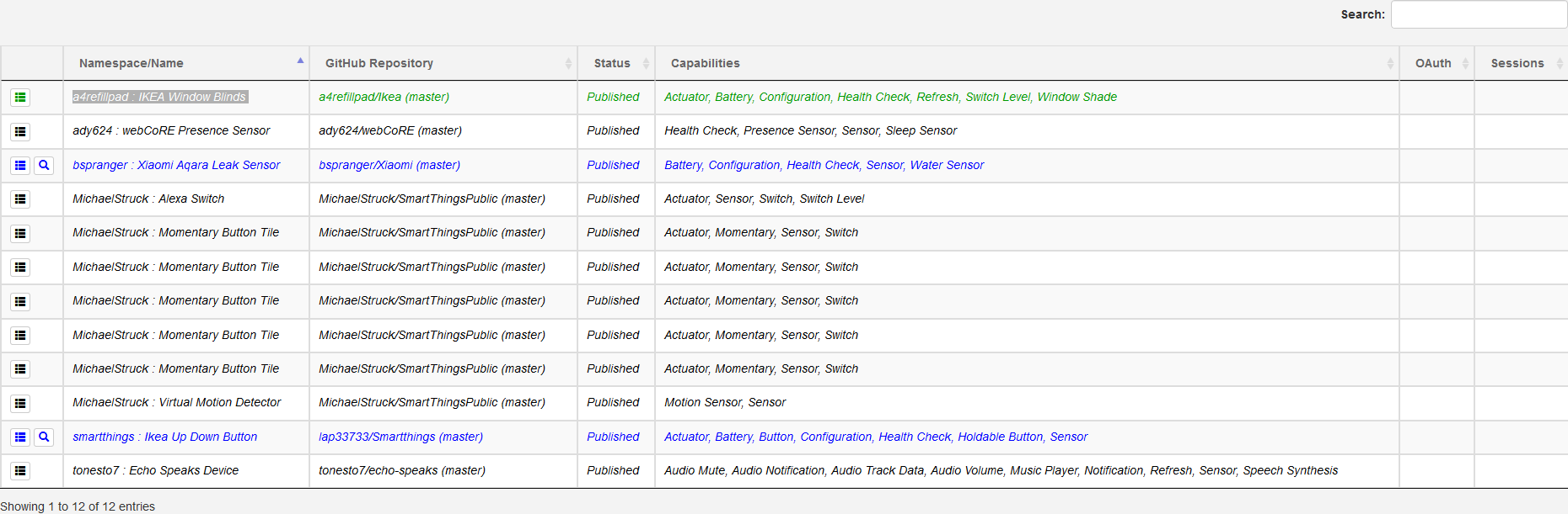

How can I check which device handler is being used? (installed “a4refillpad : IKEA Window Blinds” before adding the blinds to smartthings via classic app, after having resetted them)
How can I use the standard device handler from the new app instead?
What are the advantages?
Screenshot_2020-05-04 Device Liste(2)
Delete those DHs, or edit them at the part where the zigbee fingerprint is written. Comment it out with a // at the beginning of the line.
All those devices are using custom code on your picture.
