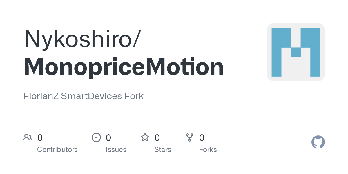

I’ve read through docs.smartthings, logged into My Devices, and can see my motion sensor properties. I searched this forum and found some code that is supposed to enable battery:
But someone else commented that the code is not formatted properly and gave a link but found an empty page:
Q: Can anyone help identify what’s wrong with the code?
Q: I’m confused on how to assign or attribute the modified code to my current generic z-wave motion sensor?
