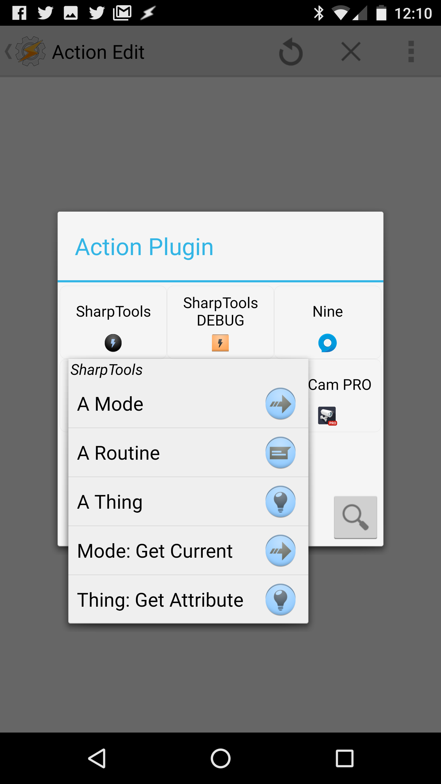

Here’s an article about using Trigger to use an NFC tag to call a Tasker Task. From the Tasker side of things, you would just need to create a new Task using the ‘A Phrase’ plugin from SharpTools to run the desired Routine.

Happy new year to you as well! I would start by reviewing the SharpTools microsite to get and introduction to SharpTools. The main features SharpTools provides are Tasker plugins and widgets for SmartThings.
It sounds like you are already familiar with Tasker, so SharpTools will help you automate your SmartThings using Tasker.
There are a number of plugins including those to control Things, Modes, and Routines. There are also plugins to get the current attributes of one or more Things and to get the current mode. Additionally there are event plugins which can trigger Tasker tasks whernever certain Thing attributes change or modes change using push events.
It sounds like what you want to do is extend an existing task to add in one or more SharpTools > A Thing, A Mode, or A Routine actions.
Yes thats right. How would I go about linking tasker and sharptools? When I edit my tasker tasks I would assume finding the relevant plugin under “3rd party” apps, but did not seem to find anything sharptools related there.
I did not buy the plugin yet, since there was mention of a 7 day trial period?
It should just be under ‘Plugin’ and not ‘3rd Party’. Regarding the trial, once you try to use one of the SharpTools Tasker plugins it will prompt you to start the trial or complete the IAP. :slight_smile:
