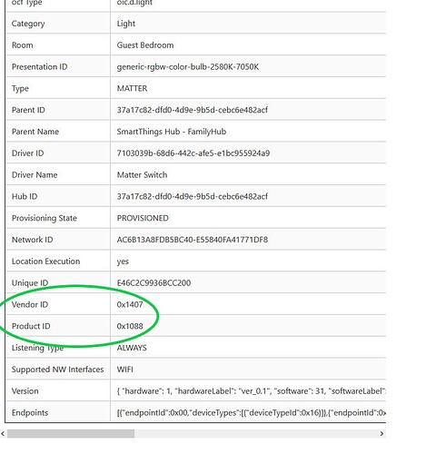

One thing to note is that the ST Advanced Web App does not provide the vendorID nor the ProductID for Matter devices (hint…it should). You can find that information in the community developed API Browser+. It also shows the endpoints available for the device and the device types for those endpoints.

Also, the ST website will not show the VendorID and ProductID. Use the community developed website I referenced in my previous post to see those as well as the endpoints and device types your device provides.
